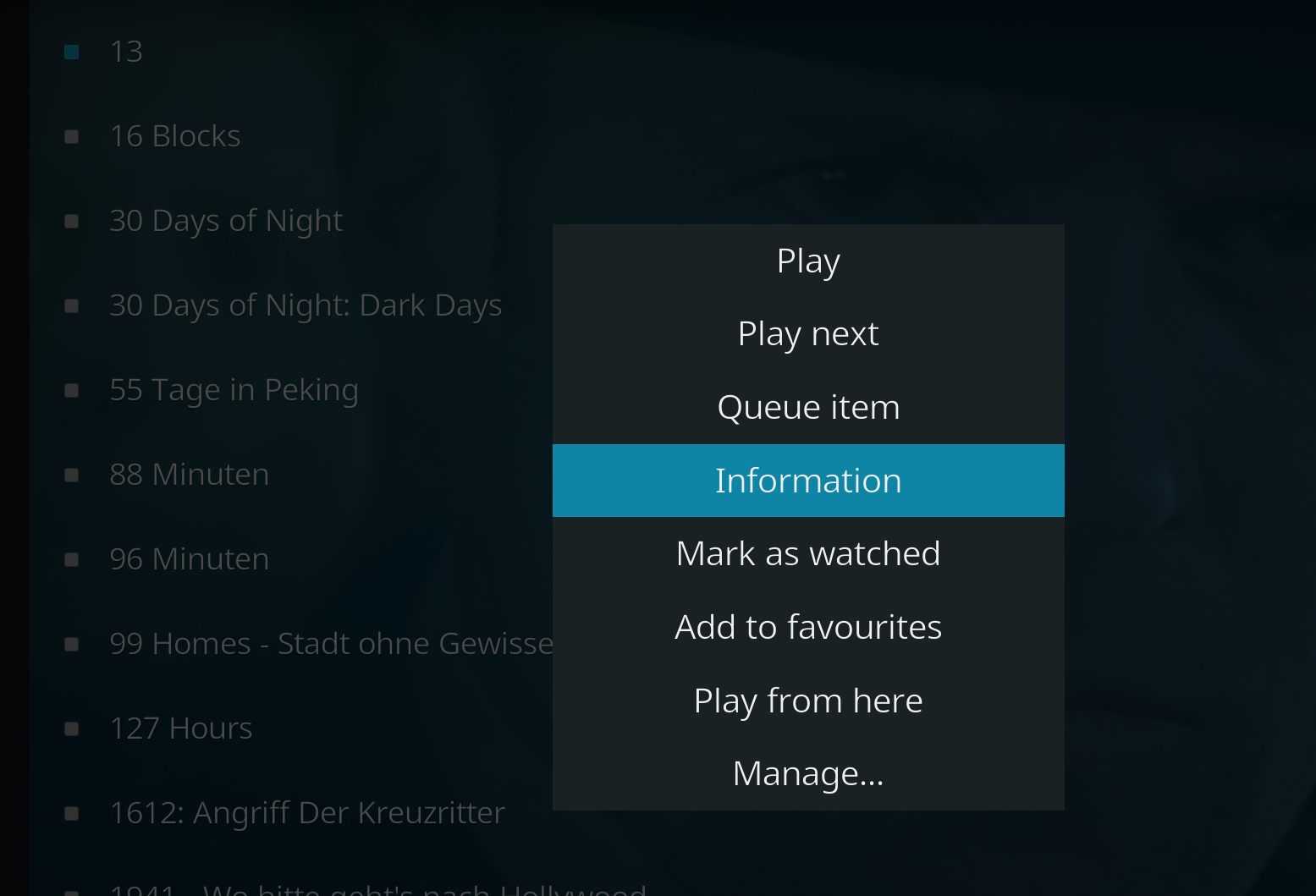

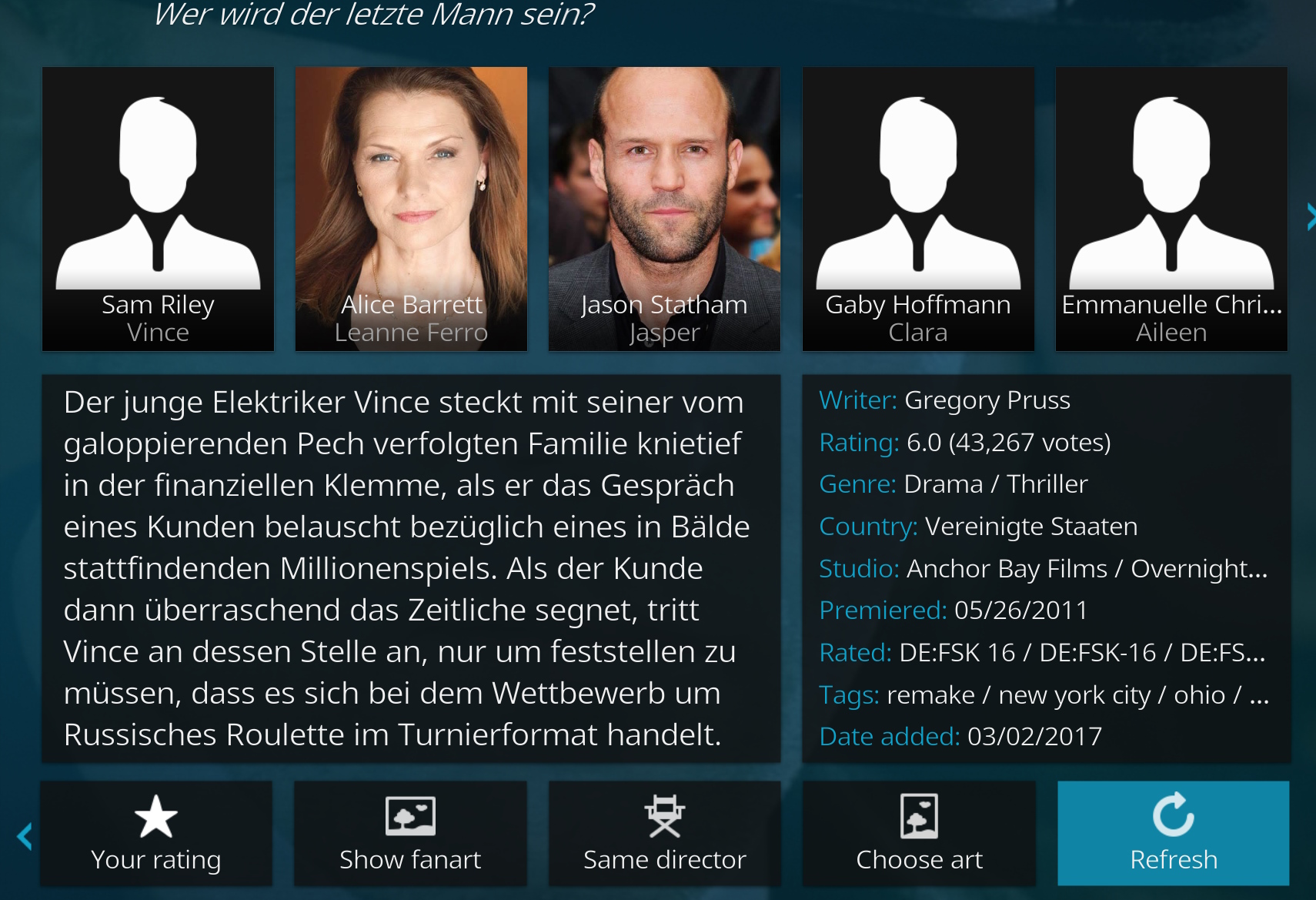

  • you can navigate to the series entry for the show you want to align at kodi and use the context button, there is a information selection where you can refreshes everything from disk
