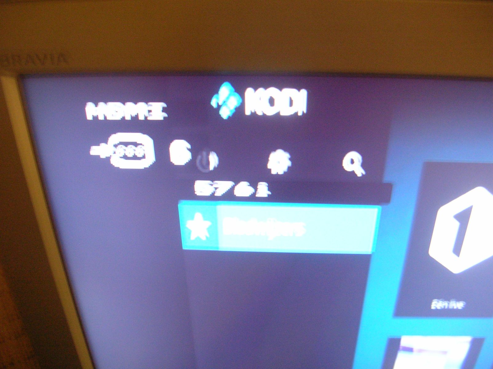

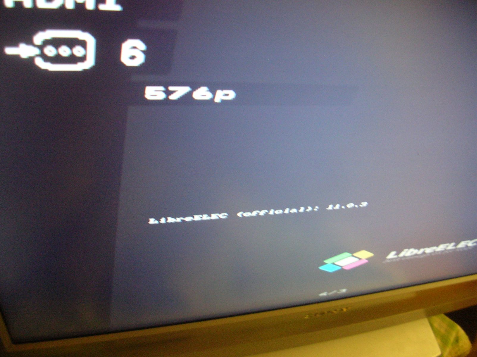

    I made two Screenshots. Look at upper left corner.
    The Pi4 is connected to a flatscreen TV with it's HDMI input.
    (if I connect it to my retro CRT I can take a picture of "no picture"during boot lol :) )
    1. during boot (wrong):
    2. When Kodi is started. (fine)
    Am i overlooking something?
    Is this a bug?
    Would you want to try to reproduce this issue on your hardware for me?
    Greetings & thanks for the effort!
  • LE doesn't support interlaced mode on RPi, so switching to progressive is expected.
