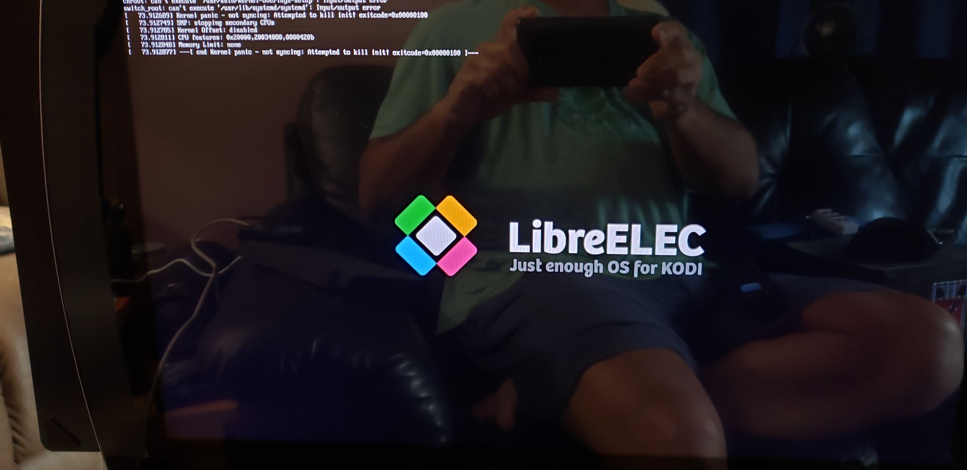

  • Well, after hours and hours of trying, I did manage to get LE to work on the SSD drive, but it keeps failing at different times. If I copy files from my PC over to the addon folder, it stall, I get errors and the RPi reboots, freezes, or sometimes it says that it is beyond repairs (or similar message). I installed LE on the SSD driver over 7 times, and every time it fails at some point or the other. I eventually gave up and installed it on a Sandisk 128 GB MicroSD using the latest Nexus release, but it is very slow compared to my existing older ZBOX. I then installed LE 10.0.4 which is a bit faster than 11.03 but it gets stuck in a loop for over 10 times before booting to the LE interface, and also locks up and sometimes it just reboots. It has been a horrible and frustrating experience thus far. And as for the SSD drive. I did try 3 different brands, Samsung, Sandisk and Kingston, and they all fail. I don't think the SATA adapter is the issue either, because I tried 2 costly brands and same problems.
    Sorry for the multiple posts. Maybe someone can offer some advise.
    Thanks,
    Shedrock

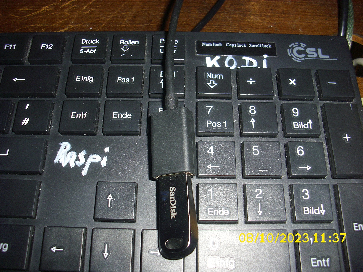

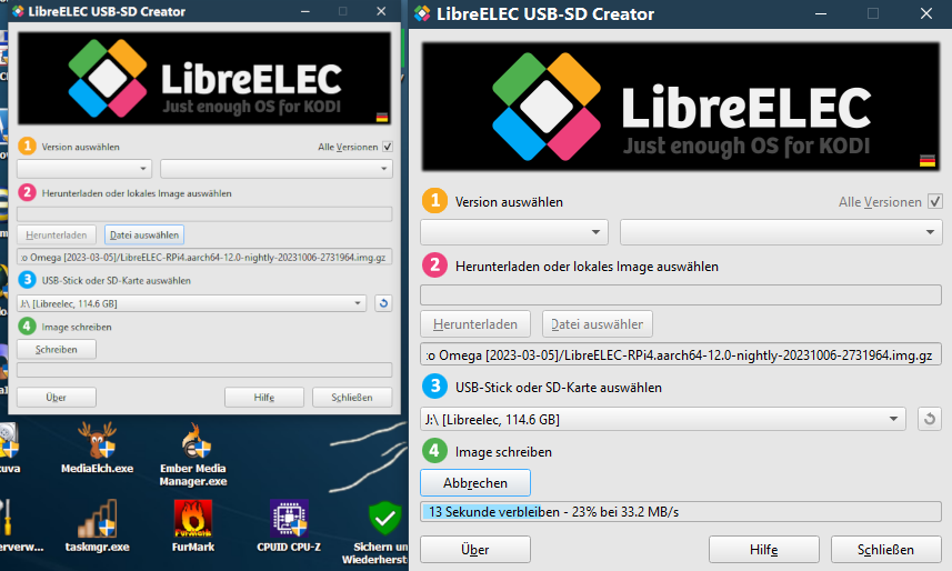

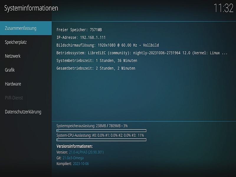

  • Good morning
    I format the SD card, USB stick or ... under Windows in NTFS and so far the "LibreELEC.USB-SD.Creator.Win32" version 1.4 tool has always recognized everything
    no matter whether LE 11 or Nightly 12
    (translated with Google)
    greetings
    Edited once, last by johnny depp (October 8, 2023 at 8:21 AM).

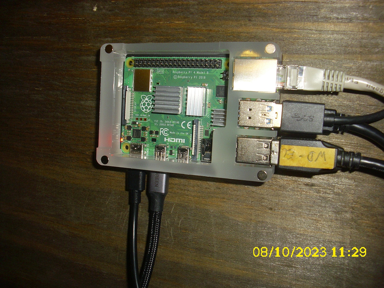

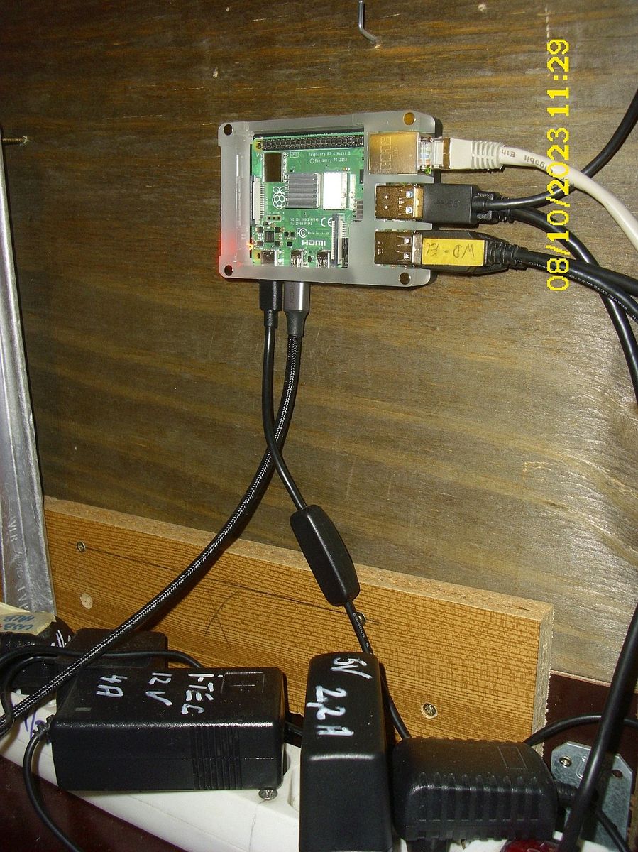

  • As noted by johnny depp the installer app should be able to see the USB drive under Windows to write the LE image directly to the SSD. RPi images do not boot into an installer where you pick the install target (as in the Generic image).
    Does the SSD have it's own PSU or are you trying to power the SSD from the board? .. and what PSU is being used?. Note that USB booting has a much higher current draw on the board than SD card and will need something like the official Raspberry Pi PSU that's rated for (and will actually give) 5V/3A to avoid power brown-out issues; which from the description of boot failures and reboots is my guess/hunch on the problem. You might also need config.txt changes to boost power on the USB ports and some USB drives still suck enough current to need their own independent PSU. For kicks, you can also boot an LE12 nightly from SD card and ensure any available firmware updates have been applied (via updates in LE settings).
    If this all sounds fiddly, please remember the board was designed to boot easily from SD card (and that bit works easily and as advertised). If you want to go off-piste with more exotic boot scenarios it's not quite as straightforward.
    Thanks,
    Shedrock

  • Does the SSD have it's own PSU or are you trying to power the SSD from the board? .. and what PSU is being used?. Note that USB booting has a much higher current draw on the board than SD card and will need something like the official Raspberry Pi PSU that's rated for (and will actually give) 5V/3A to avoid power brown-out issues; which from the description of boot failures and reboots is my guess/hunch on the problem. You might also need config.txt changes to boost power on the USB ports and some USB drives still suck enough current to need their own independent PSU. For kicks, you can also boot an LE12 nightly from SD card and ensure any available firmware updates have been applied (via updates in LE settings).
    The SSD drive does not have its own PSU. I read on a few threads that the RPi4 had sufficient power to run it, so I assumed that everything was going to be fine. I do however agree that this may be a power issue. Although, it still doesn't explain why LE fails at some point on the MicroSD cards as well. I will pickup a PSU for the SSD drive and see if that sorts things out.

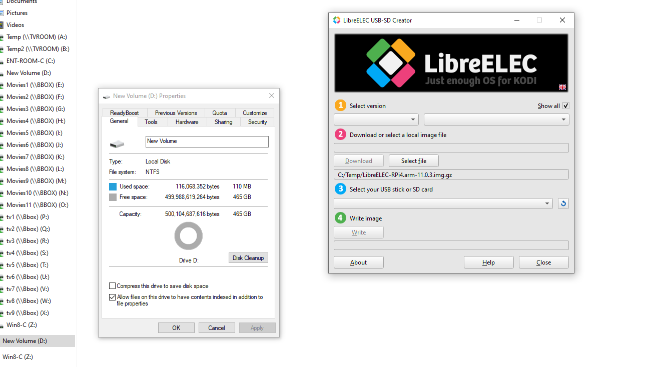

    Good morning
    greetings
    Here is a pic of the drive formatted in NTFS and not being discovered in the selection drop-down menu in the LE creator.
    Shedrock

  • UPDATE: I tried switching the SSD to USB2 but that did not do anything. What I decided to do was to take an old SSD drive power supply, modded it and plugged in the drive. I then installed LibreELEC-RPi4.arm-11.0.3 and it installed faster and booted up faster as well. It is however much, much slower than my ZBOX -ID88, and that's saying something, considering that it's over 11 years old.

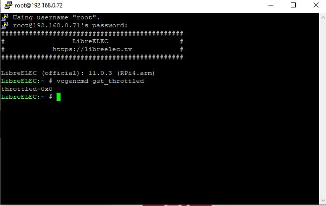

  • As you didn't post any debug logs yet it's really hard to tell what's causing your issues (sorry, my crystal ball is still on repair).
    A few hints though: you can easily check if your RPi is suffering from under-power issues with vcgencmd get_throttled - insufficient power supply by using random phone chargers etc is still the number one cause of "this damn thing doesn't work reliably".
    If you connect some external peripherals like SSDs also have a look at their power ratings. I don't have an EVO 870 laying around on a shelf but the 500 GB EVO 850 I found in the spare box mentions "5V 1.4A" on it's label. Now keep in mind the RPi4 will at maximum deliver 1.2A (together!) on all USB ports and do the math. Even if you don't have an USB keyboard plugged in it won't be enough (and your USB->SATA adapter will need some power, too).
    Some 250GB Micron and Sandisk SSDs I found in the box even need 1.6 or 1.7 amps.
