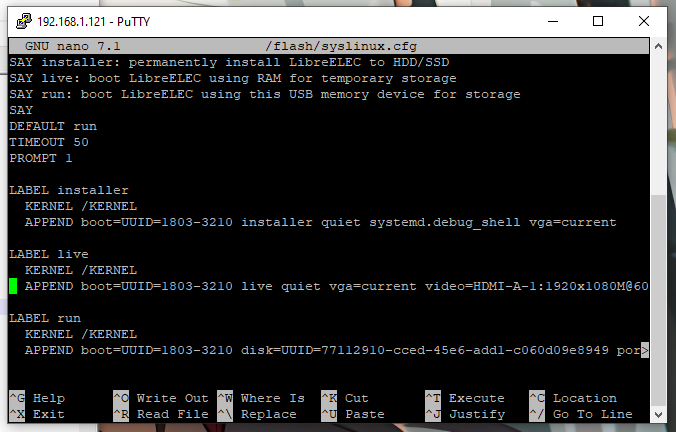

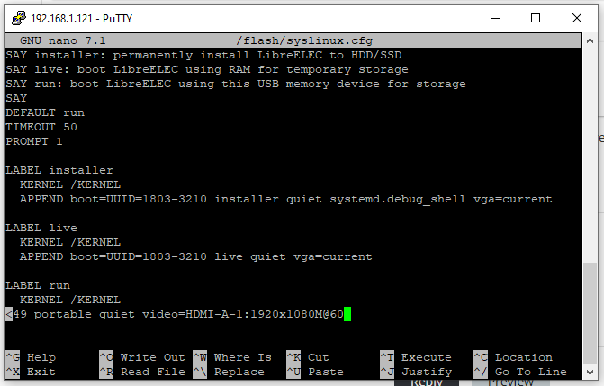

    So, I managed to add the line:
    video=HDMI-A-1:1920x1080M@60
    to /flash/syslinux.cfg by remounting the /flash partition in read-write mode. However, after rebooting, I still get Kodi on the internal screen instead of the HDMI. Did I do something wrong? I would like to know!

  • Nah, append that line right after vga= current at LABEL live section.
    I added video=HDMI-A-1:1920x1080M@60 after vga=current.

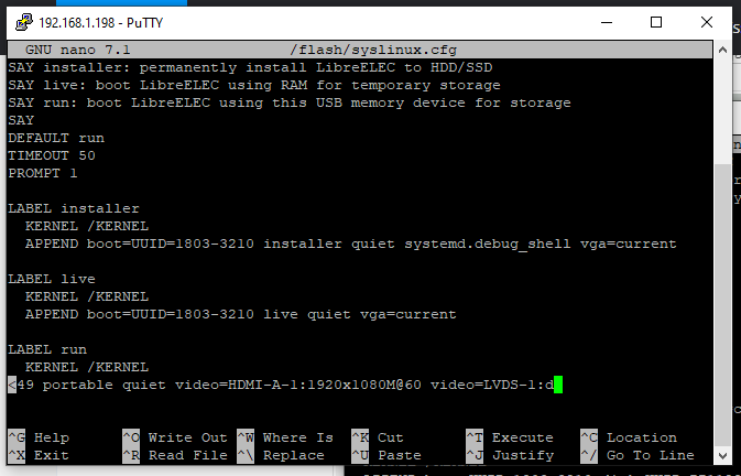

    I have this output from the command line:
    Revisory:~ # ls /sys/class/drm
    card0           card0-LVDS-1    renderD128
    card0-HDMI-A-1  card0-VGA-1     version
    I want to ask if I should add video=card0-LVDS-1:d or video=LVDS-1:d. Additionally, if I do so, should I add it to LABEL live and LABEL run as suggested by @19921-da-flex (I'm not sure how to use the mention function)?
  • a) Add video=LVDS-1:d
    b) With DEFAULT run in syslinux.cfg use "run". You can check the kernel parameters with cat /proc/cmdline
    This is what I did yesterday:
    And surprisingly, it works, and now the screen is on the HDMI. Anyways, thanks for the support!
