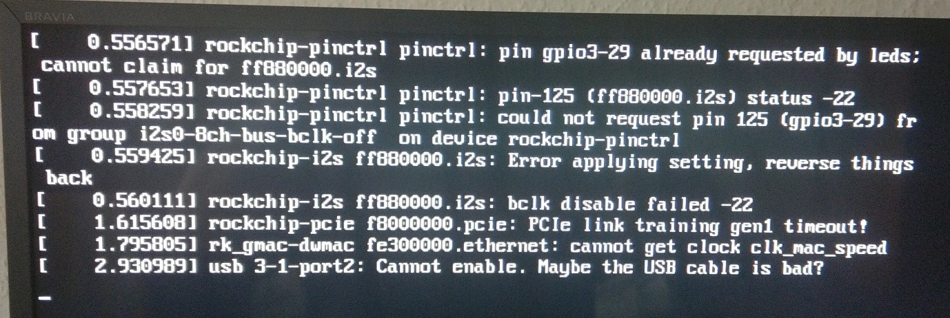

  • I have the same problems. Fresh installation of 10.95 and/or 11.
    The hard drive is no longer recognized.
    Attached to the Windows-PC there are no problems.
