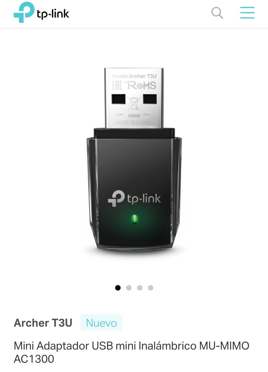

Why doesn't this work for my wifi???
Please provide output of lsusb so I can take a look which driver is needed.
https://www.tp-link.com/es/home-networking/adapter/archer-t3u/
I don't know what you are asking but in that link you can see all the characteristics of the product
RTL8812BU chipset .. which has no support in the upstream kernel: http://en.techinfodepot.shoutwiki.com/wiki/TP-LINK_Archer_T3

RTL8812BU
ah, yes, RTL8822BU would work, but not RTL8812BU...
deleonkikko bad luck, try another wifi dongle.
I have two of these, works with rtw88 driver from 6.2 + usb patches & fixes from wireless mailing list. I think those are all rolled into the Allwinner builds, so maybe it's just enabling the module or running a later image?

I think the Allwinner problem is this maybe:
# CONFIG_RTW88_8822BU is not set
frakkin64 you're right, thanks for that info.
deleonkikko please test image or update from here: http://jernej.libreelec.tv/test/opi3-lts/ your archer wifi should work.
