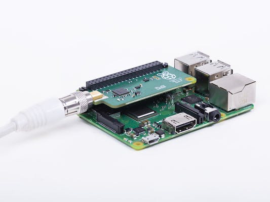

    Just purchased a very cheap (£6.49) unofficial raspberry pi tv hat and to be fair the quality of the picture is pretty good considering the price. The question I have though, is there a tv tuner that will produce the same or better picture quality as the tuner that is built into my 10+ years old pioneer tv. I have a humax box attached to the tv at the moment and although the picture is slightly better than the pi tv hat, it is still not as good as the on board tv tuner. Am I doing something wrong or are my expectations unrealistic to think that I can get an equivalent picture quality form a computer peripheral. I am in the UK and most of the tv channels that I watch are only SD quality and of course the pi and the humax are attached to the pioneer via hdmi cables and i am pretty sure I have the correct output set on both the pi and the humax, but the picture just does not look as crisp. In fact i would say the humax and pi HD channels are about the same quality as a SD channel just using the pioneer tuner.

  • It is what is. A project accessory and priced accordingly. It’s not an appliance module that justs works out of the box. As was suggested do a little research on it. There plenty of examples of working projects out there you could investigate and learn from. It’s obviously a good starting point for a DVBT server which you can use to serve TS to a client and let the client do all the video processing. Here’s a typical example of one.

  • I’m suggesting you use the Pi Hat/RPI4 Combo as a streaming device. You can then stream to any device attached to you Network you like to make comparisons. I find the Raspberry Pi very limiting when it comes to playing video. Just pass the transport stream received by the Pi Hat to something a little more capable of processing the transport stream to make comparison between it and your built in setup. In fact the Pi4 is overkill. A Pi3 would be satisfactory or even a Pi Zero W as far as I know. As I suggested research other projects and you’ll see exactly what I mean.
  • This thingy effectively prevents you from having a heatsink? I don't see the point then unless you're okay with not fully utilizing your RPi 3/4 CPU and GPU. And Pi Zeros lack Ethernet so they won't make very good job of distributing channels to LAN. Personally I was thinking about getting DVB-T2 USB stick. But I don't know how good is their support under LE and Kodi.
