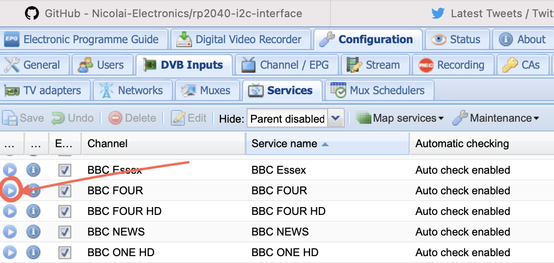

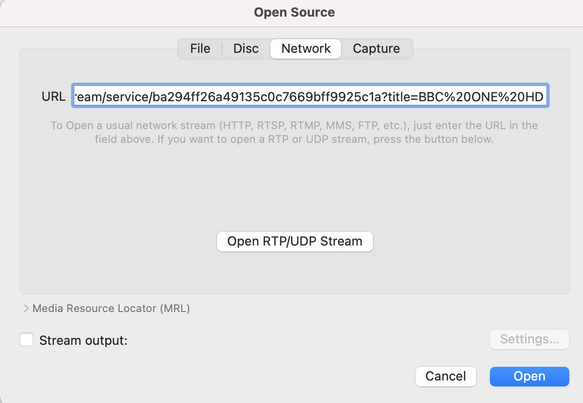

    Are you able to test on a Windows or Mac laptop running Kodi over a network connection to your TV Headend + DVB-S capture solution box Or by running VLC and taking the http streams from TV Headend's UI?
    (To test in VLC you copy the link from the play icon - by right clicking and copying the link - next to the channel in the Services tab and then paste the link it into the Open Network option in VLC)
    That way you can confirm whether the issue is with TV Headend and the DVB Reception, or your Kodi playback environment.
