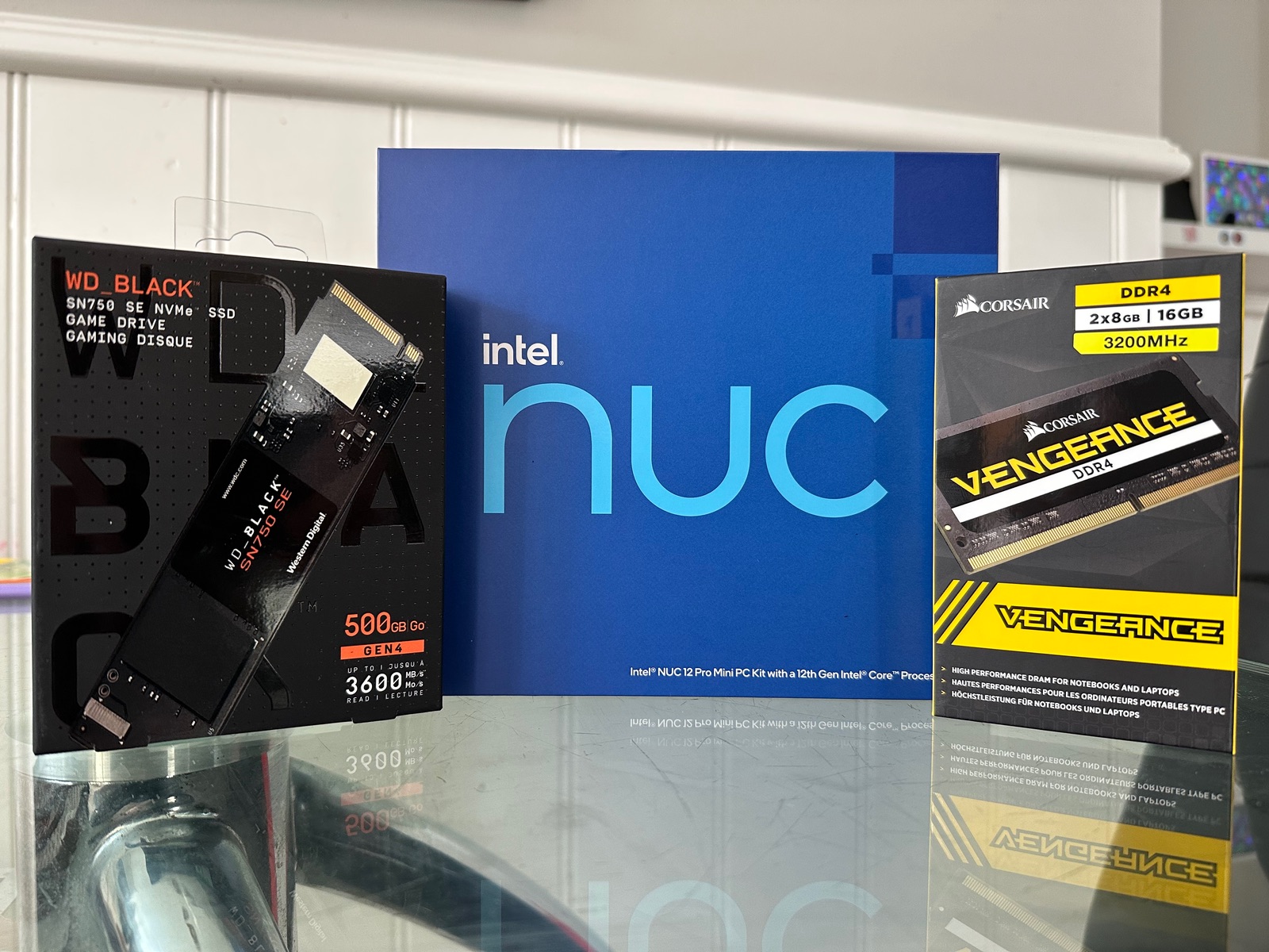

New 12th gen Intel Nuc
atoulmin -
October 19, 2022 at 8:09 AM -
Thread is Resolved
Cool ! Very curious to see how you get on as that's on my "procurement list" too
