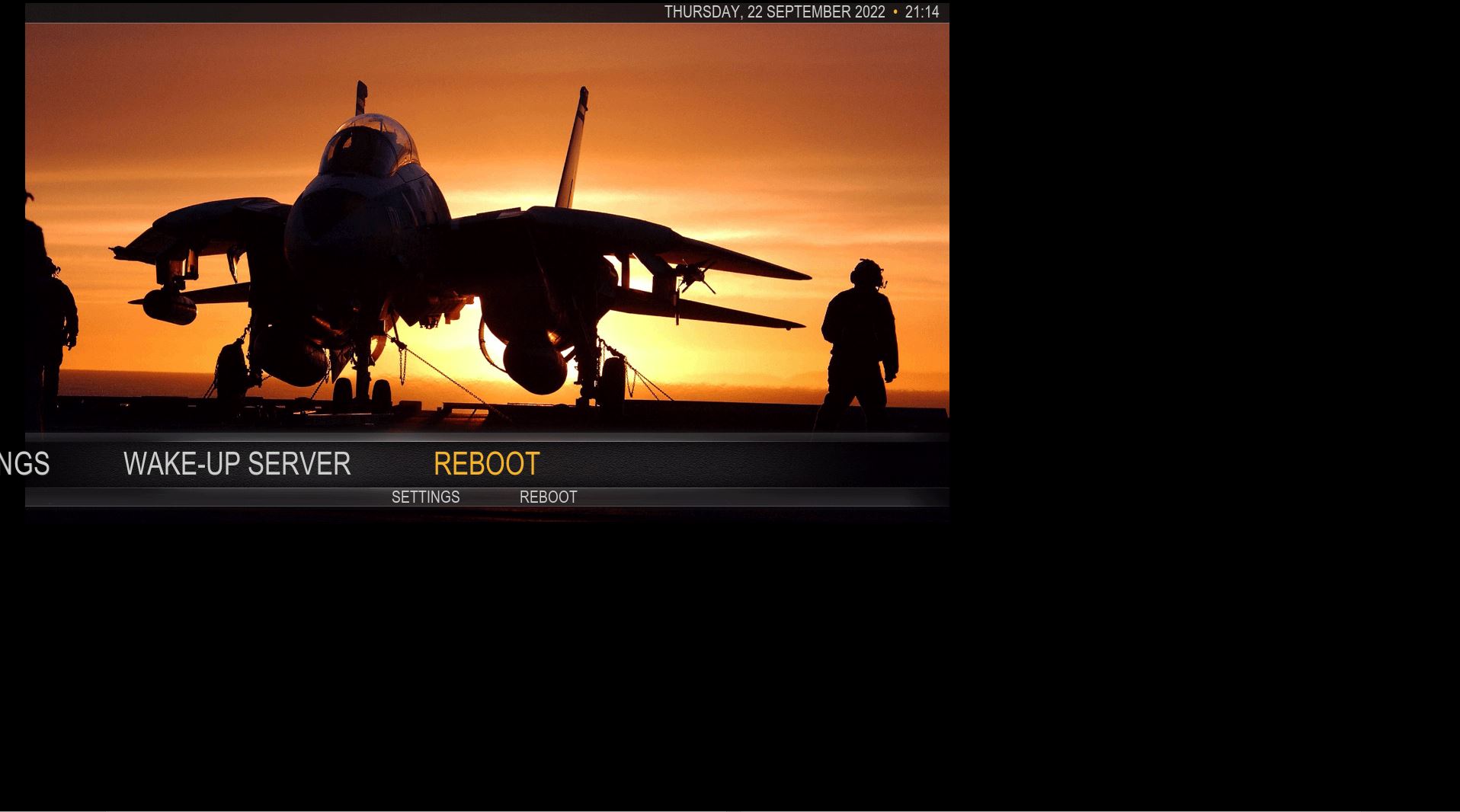

    the TV reports 1080i, but the libreelec Gui is not adapting to the higher resolution and therefore just like a window in the upper left corner of the TV, while the rest stays black (see picture). And I cannot change the display resolution in the settings to the 1080i, there is no option.

  • Kodi always and only outputs progressive. Interlaced 25/29.97/30 media requires 50/59.94/60Hz modes from the TV so that each interlaced frame (two half frames) can be rendered progressively (in two progressive frames). Hence the highest resolution Kodi can output is 720p (mode 4) and there is no 1080i to select.
    I've run LibreElec on a Pi via an HDMI->HD-SDI converter in 1080i25 output mode as a 1080i25 file player for broadcast TV. Kodi is presumably deinterlacing any interlaced media to 1080p50 and then the Pi is interlacing its output to 1080i25 (retaining the 50Hz motion), so it's not 1080i25 native - but it does retain the 1080i25 50Hz motion on its output?
    (1080i25 = 1080/50i)
