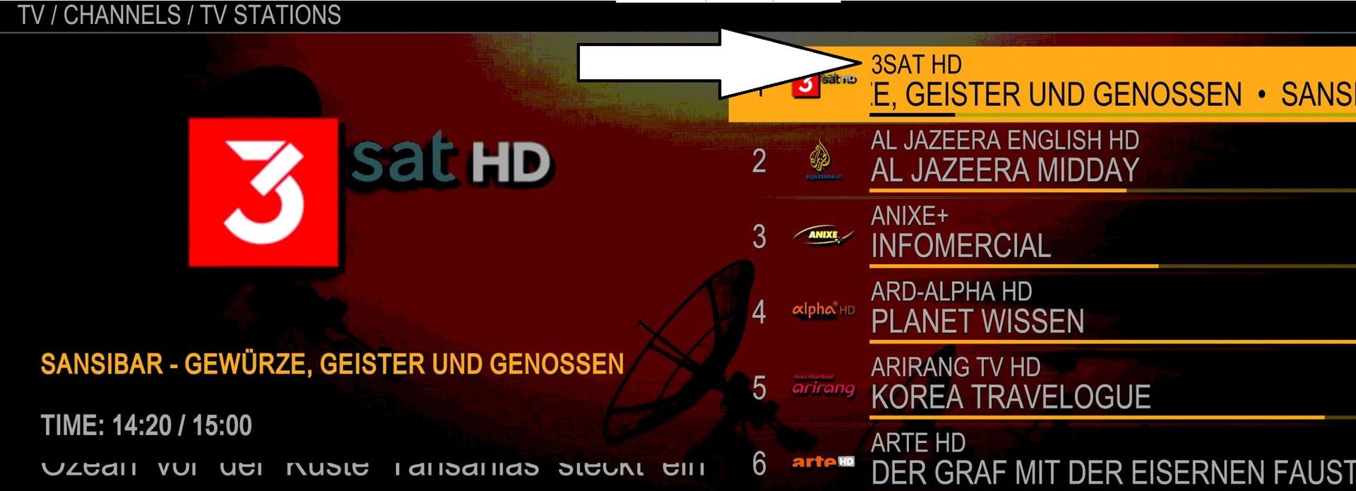

    I have Libreelec 9.2.8 on Raspberry Pi4 and I use DVBViewer Client for importing TV channels and EPG from a server to watch TV via Libreelec. Skin is Amber.
    What I would like to change is the layout on the TV page on the right hand side. I would need to increase font size of the channel titel/name, e.g. "3Sat HD" and remove the EPG data just below the title/name, if possible.
    I tried to change the "View_PVR.xml" and "MyPVRChannels.xml" (in the 1080i skin folder of the Amber skin), but I didn't succeed.
    Can someone guide me where to make those changes?

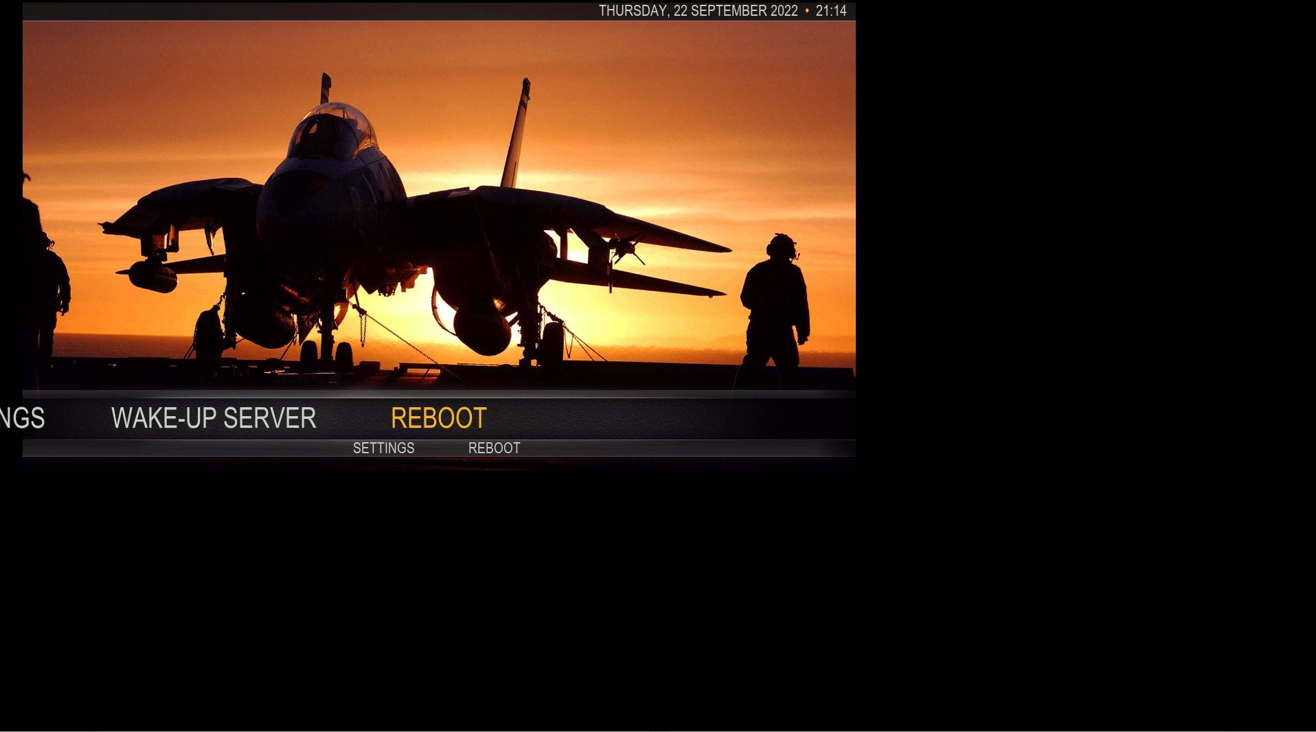

    I want to have 1080i resolution and (since it isn’t detected) checked tvservice:
    LibreELEC-WZ:~ # tvservice -m CEA
    Group CEA has 9 modes:
    mode 1: 640x480 @ 60Hz 4:3, clock:25MHz progressive
    mode 2: 720x480 @ 60Hz 4:3, clock:27MHz progressive
    mode 3: 720x480 @ 60Hz 16:9, clock:27MHz progressive
    mode 4: 1280x720 @ 60Hz 16:9, clock:74MHz progressive
    mode 5: 1920x1080 @ 60Hz 16:9, clock:74MHz interlaced
    mode 17: 720x576 @ 50Hz 4:3, clock:27MHz progressive
    mode 18: 720x576 @ 50Hz 16:9, clock:27MHz progressive
    mode 19: 1280x720 @ 50Hz 16:9, clock:74MHz progressive
    (native) mode 20: 1920x1080 @ 50Hz 16:9, clock:74MHz interlaced
    When using
    tvservice -e “CEA 5”
    the TV reports 1080i, but the libreelec Gui is not adapting to the higher resolution and therefore just like a window in the upper left corner of the TV, while the rest stays black (see picture). And I cannot change the display resolution in the settings to the 1080i, there is no option.
    So I added in config.txt the following:
    hdmi_group=1
    hdmi_mode=5
    hdmi_force_hotplug=1
    Distroconfig.txt is included and contains these two entries:
    dtoverlay=vc4-fkms-v3d
    disable_overscan=1
    But then libreelec starts always in 720p, kind of ignoring my setting. If I try then tvservice -e “CEA 5” same thing happens, Gui not scaling, while TV changes into 1080i.
    Is there something I could try in addition?
