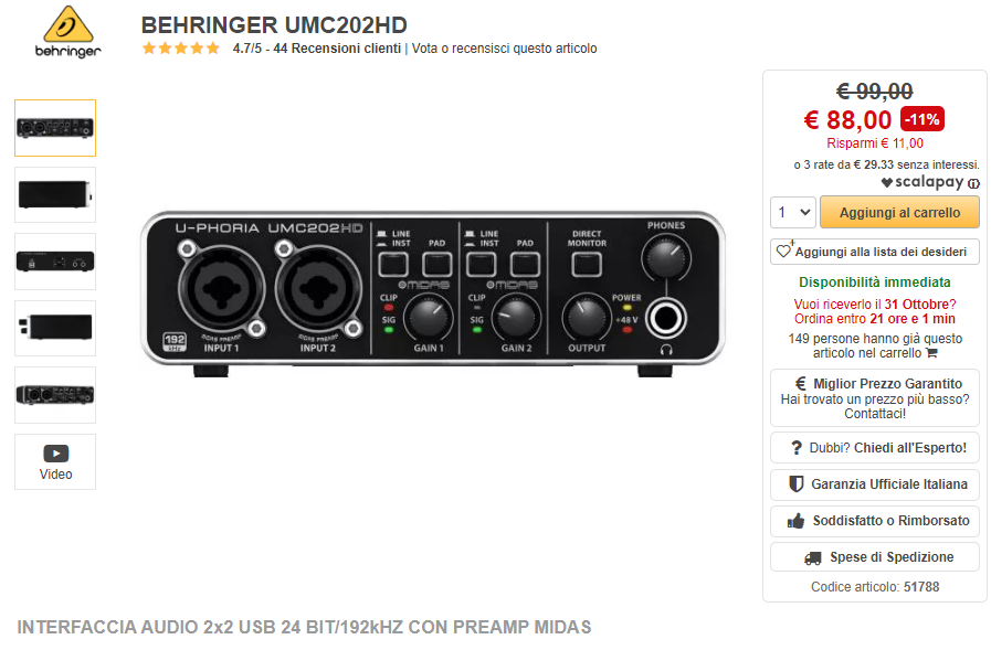

  • Standard ASIO works fine with LE. I've tested my Behringer UMC22 on RPi3B+. Connect your speakers balanced for best quality. If you also want to make music, consider to invest more to get an audio interface with bonus software (DAW, plugins etc.).
    Are you saying that if I use this via USB to my laptop https://www.behringer.com/product.html?modelCode=P0AUX it works also as a DAC?
    I just followed your link in my first tread I opened because my needs is to convert USB audio from my laptop to a analog pre - RCA
    If that behringer works , is these one also fine ?
    I do not see RCA outputs...
    I need it to record concerts (2 XLR in + 96 khz)
    Thanks
    Edited once, last by Sargon (October 27, 2022 at 4:07 PM).
  • Every audio interface / DAC with standard ASIO driver works on LE.
    An audio interface is a DAC plus input (ADC).
    You could convert from TRS to RCA by a cable.
    If you definitely need RCA output, take this (I think it also uses standard ASIO driver): Click!
    If you want to record, then LE isn't the right software, and you need a DAW instead.
    However, you can use the same audio interface for both software.
    Not sure which driver is used by the UMC202HD. Ask the Behringer support team about Linux compatibility.
