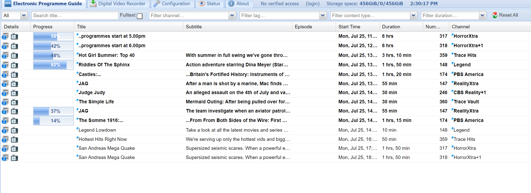

  • Hello, I'm new to using LibreELEC and tvheadend so I apologize if I'm missing something obvious or not providing enough information. Exactly a week ago, I set up LibreELEC and tvheadned to receive UK Freesat over a USB DVB-S receiver. The problem is that there isn't any EPG data being listed besides around 15 channels. I've tried re-running the internal EPG grabbers but that hasn't made a difference, I'm not sure what I should attempt to do to resolve this. I'm still able to watch the channels.
    With that said, I've read that the Freesat EPG is 7-days in length which would correlate with me losing EPG data exactly a week after setting up tvheadend. Any suggestions on how to proceed would be greatly appreciated. If there's any information I could provide please let me know. Thank you in advance!

  • Just grabbed an EPG xml file from TVH. A total of 50,000 plus entries of EPG. Most are 7 day with a number being 5 day. This is all off a DVBS scan of the two TP’s I mentioned above.
  • Thanks for the help, I really appreciate it. I probably should've posted this in the TVH forums sorry about that. The solution that worked for me is that I added 11425H and 11778V to the mux scheduler. For some reason 11426H wasn't available to me but I guess 11425H works as well?
