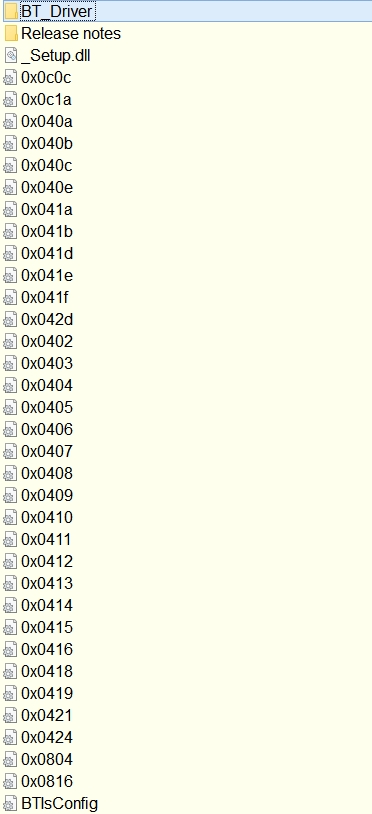

  • I too have this (UB500 TP-link) dongle and am running Generic.x86_64-9.1.002 (Leia), which I don't want to change from, for various reasons (namely running Chrome)
    I looked at the link above to add firmware and even tho I'm reasonably computer-savvy, the first method looks too hard for me.
    The second method (shown in video) I could do - I've accessed folders on my Kodi installation from my Win10 machine (over the network) before.
    but how do I identify the firmware for the USB stick?
    I have a folder that I unzipped to install it on Windows 10 (screenshots attached). Is any of that firmware?
    Can someone please tell me how to find the firmware for my dongle or perhaps even ELI5 me the process to use this dongle on my Kodi install?

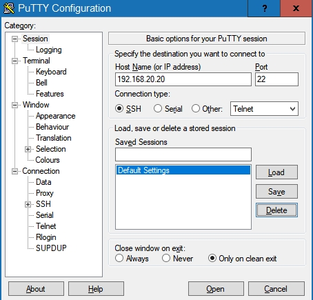

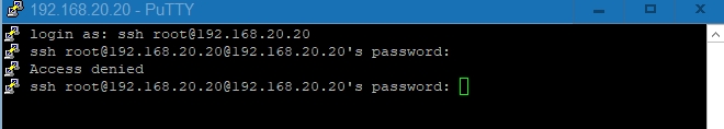

  • Can't SSH into Kodi
    1. What am I doing wrong? So frustrating!
    a) Note: when I type the password into PuTTY, the cursor doesn't advance
    b) I did at first encounter the warning in the third shot. First I did 'connect once'. Then 'accept'.
    c) The ip address, user ('root') and pw are all definitely correct.
    2. What is a 'clean boot' into Kodi precisely?
    3. Is there another way I can get you the log?
  • Thanks PE! That saved some time but still access denied.
    I know its the right password.
    (Note: cursor doesn't move when I type password - blindly!)
    Far better results using Windows CMD prompt than PuTTY
    1. Wow, I just managed to log in on the first attempt using CMD (run as admin).
    a) OpenSSH Client was already installed.
    2. I'll be uninstalling PuTTY. I didn't find it very useful.
