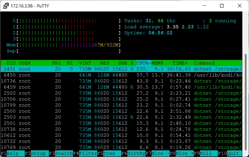

  • I just set up NextPVR for a simple test on a RPi3 with the LE service addon with two HDHR tuners and was able to play one channel in Kodi and stream 3 other 1080i channels to other clients. I think caching to the the SD card would be my big bottleneck here two.
    From top
    2491 root 20 0 752420 103188 33204 S 222.4 10.9 21:05.28 dotnet
    1929 root 20 0 641076 93252 20084 D 51.0 9.9 39:23.09 kodi.bin
    LE doesn't have htop but the 224% CPU seems about right for these slower SoC's. Recording 3 streams and watching one is much less CPU intensive which is probably a better use case. TVHeadend on the RPi3 might be a little lighter, though if this troubles you but I'd probably go with a bigger box myself for this kind of use.
    Martin
