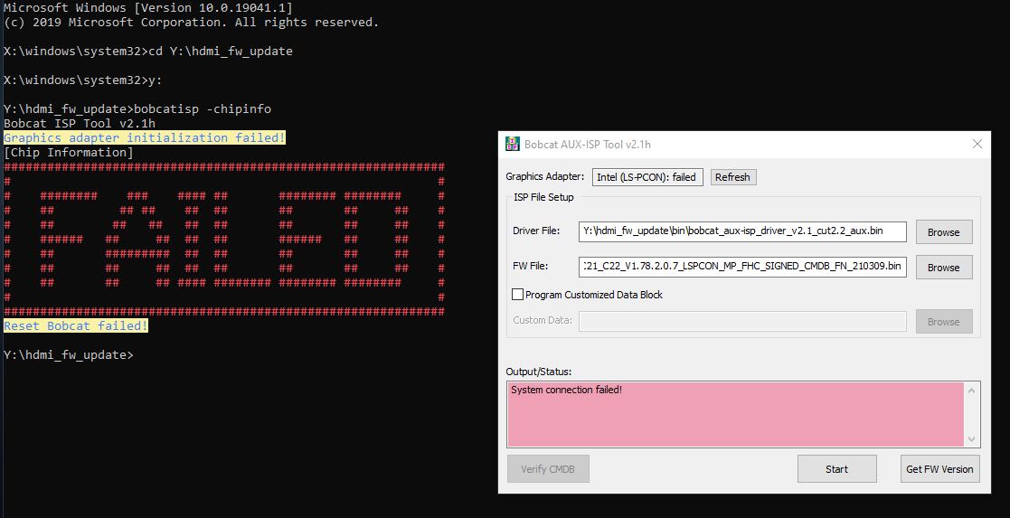

  • So I tried to use win-to-go usb stick to run Win 10 out of it and execute that hdmi patch from Intel (as this exec is running only from Win 10) - hoping that this approach will not jeopardize my LE setup there.
    What a pain! Tried with 32 and 64 bits Win 10 recovery disk, then official Win 10 iso images (again 32 and 64 bits) which Rufus can use to build win-to-go usb stick - and neither worked properly, they did not want to boot or were crashing soon after booting. Finally it booted nicely from HirenPE, and then (obviously) Intel tools started failing, I suppose as Hiren is missing specific NUC drivers.
    So here is my collection so far - screenshot and the log file:

    Hiren seems to have option to add custom drivers, but the problem with NUC is that most of these drivers are in a form of exe file which just need to be executed on the device. Ughh.

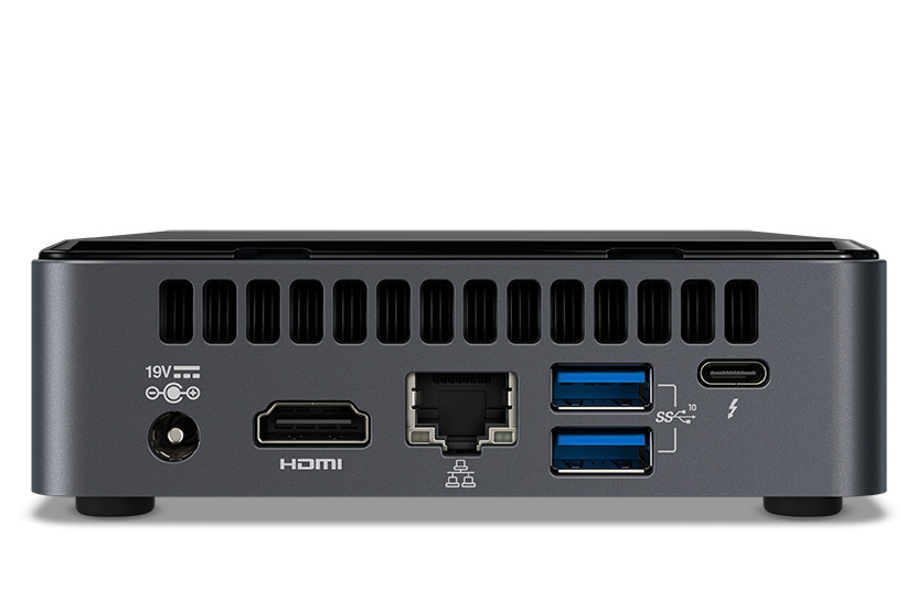

  • I guess it is cause your NUC do not have audio output (cinch ?).
    AFAIK, your NUC transfers audio via HDMI/DP

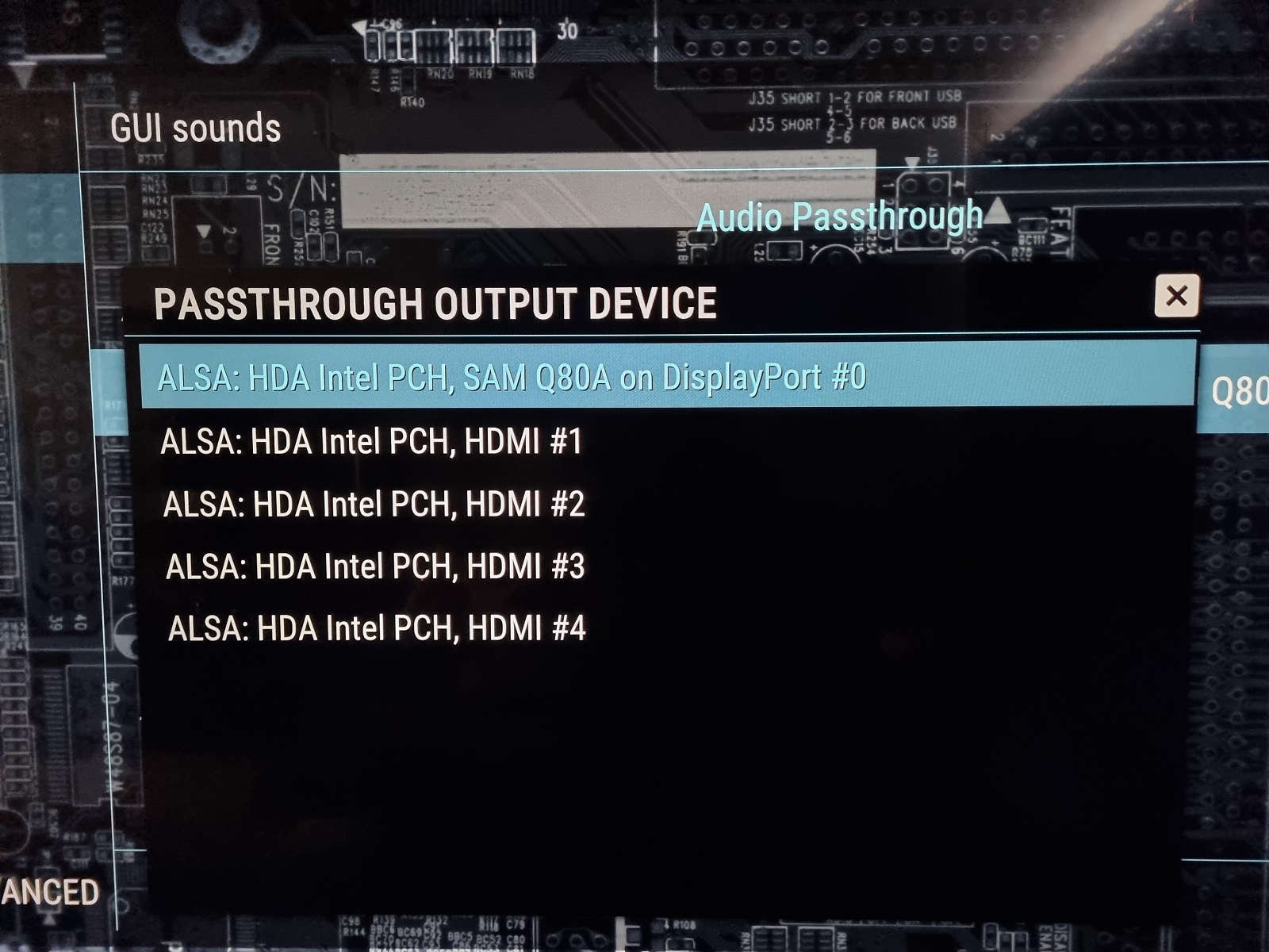

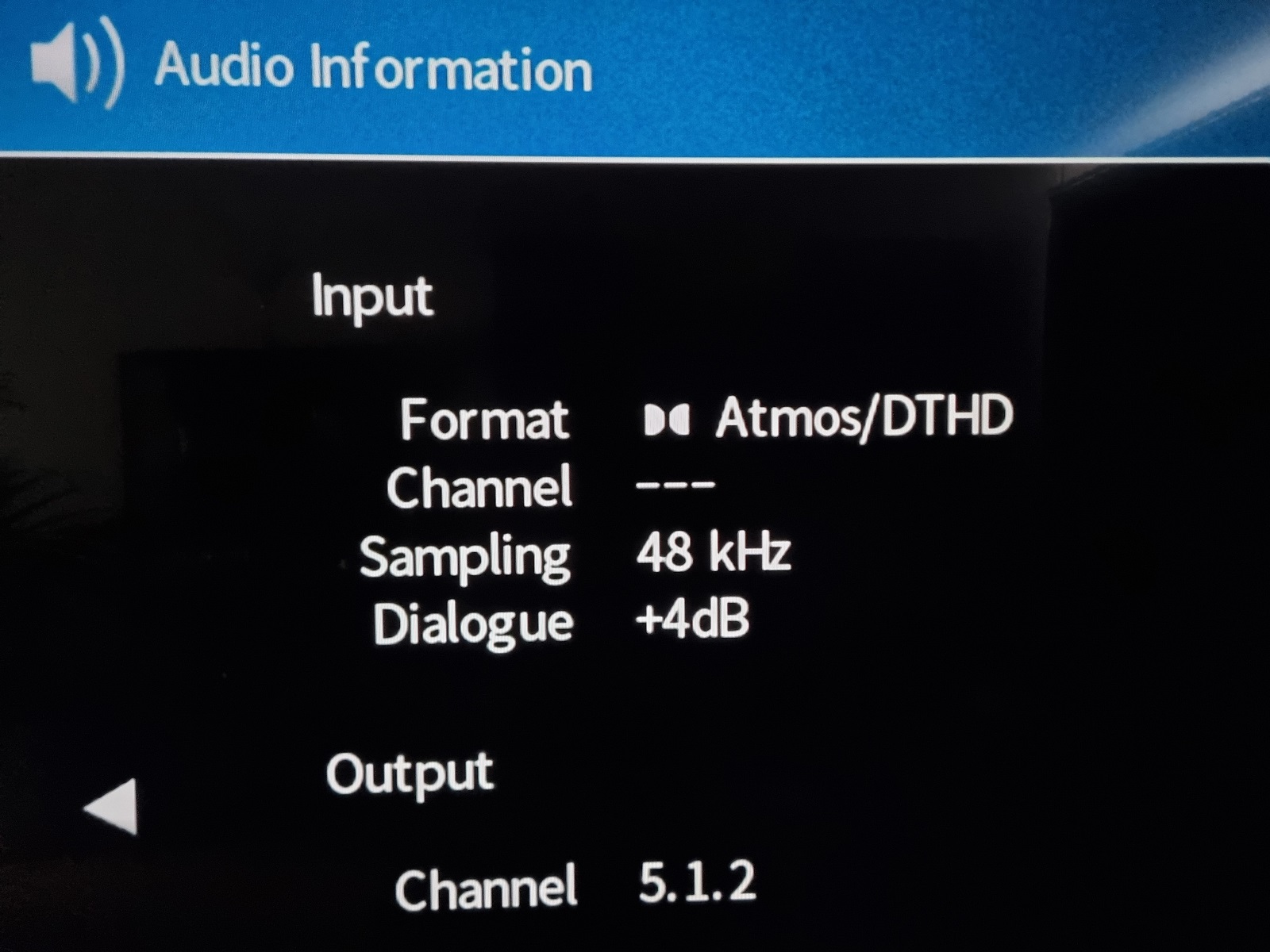

  • Problem solved in a trivial way, although I'm not following it :D

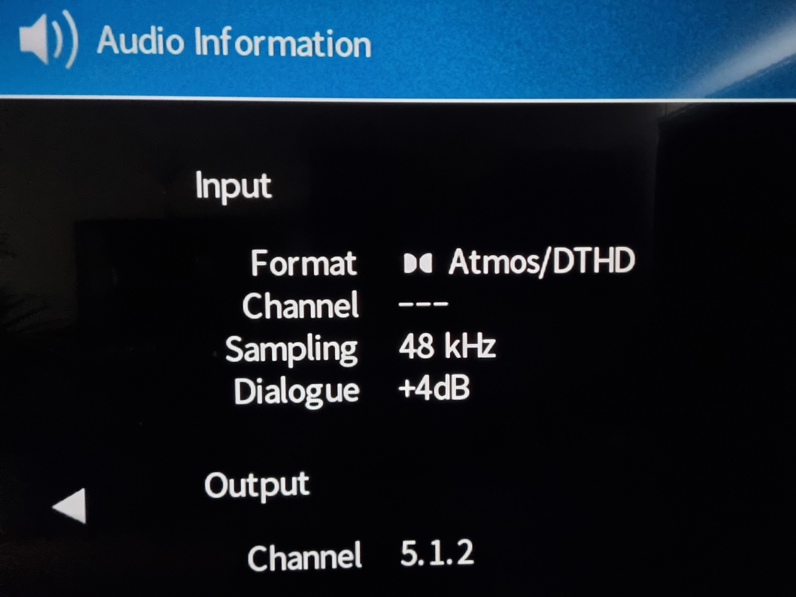

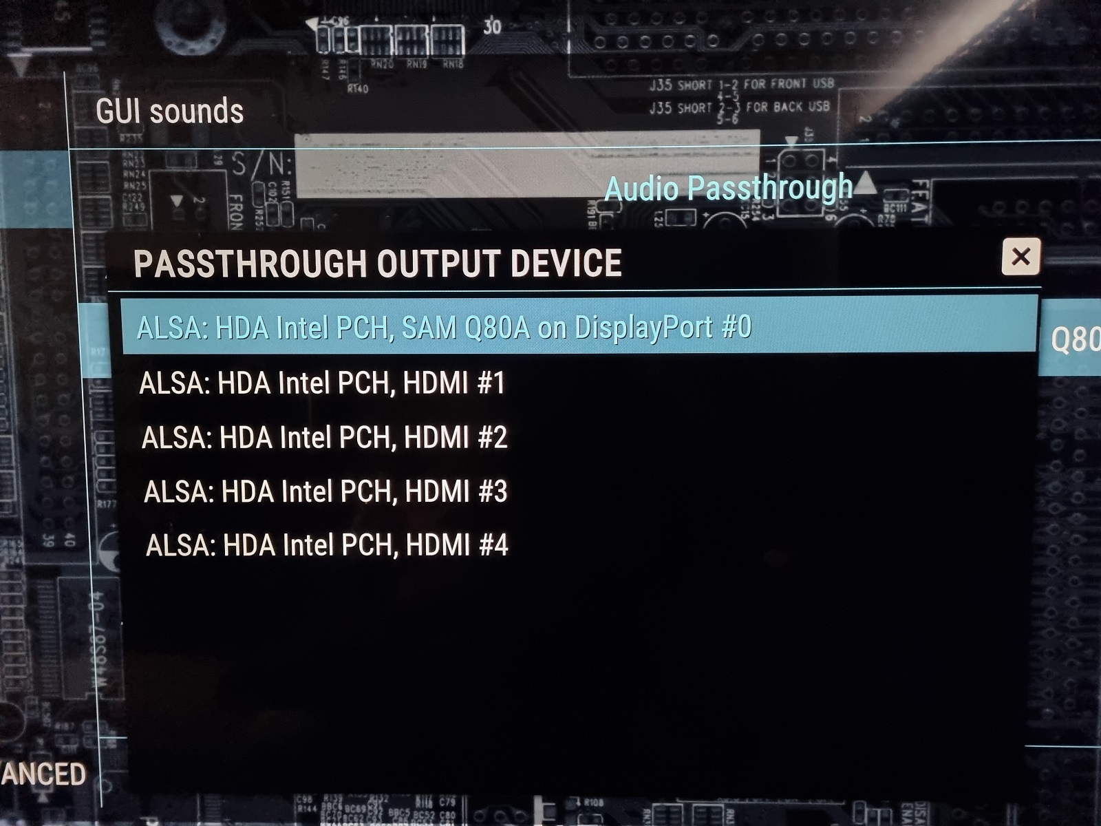

    So in all my tests I was using HDMI #1 output device as NUC is connected to AVR over HDMI. And I was considering DisplayPort #0 as the USB-C output which I'm not using (see the attached list of recognized devices). But when I switched it to DisplayPort #0 (just in the LE setup), passthrough streaming started working (see attached example Atmos/DTHD input received in the AVR). And this is just setup change in LE, the physical setup is still the same: [NUC]--hdmi--[AVR]--hdmi--[TV].
    So now all audio formats are working great in passthrough mode but I don't understand why :D Is it a bug or expected feature?
