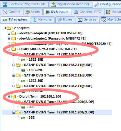

  • For tvheadend to automatically recognize a SAT>IP tuner, it only needs to be turned on and on the same subnet or home network. You can also force the discovery of a SAT>IP tuner with the parameter "--satip_xml http://<satip-tuner-ip>:8080/desc.xml" for Digibit R1 or "--satip_xml http://< satip-tuner-ip>:38400/description.xml" for Digibit Twin, in the command line for tvheadend server startup.

  • The Digibit avoids the need to muck around with drivers in Linux / LibreELEC which is the achilles heel of DVB tuners. My Digibit R1 sits on a shelf in my rack and never misses a beat, hands down the best DVD-S2 tuner I've ever had and I've had a few.
    CA configuration is not different using the Digibit than with a USB/PCI tuner.
