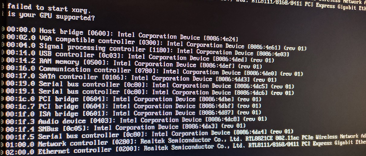

Hello. I installed libreelec on Gigabyte Brix BMCE-5105 ( jasper lake celeron n5105, intel uhd graphics 605 ).
After the installation completed and reboot the pc I get a message:
failed to start xorg
is your gpu supported?
any help please?

what I can find is this:
[SOLVED] No Graphic Driver Offered for Gigabyte Brix GB-BMCE-5105 - Linux Mint Forums
long story short:
it seems you need a newer kernel, what is in nightly.
and that's here:
key in "gen" in the grey box to filter the images for your device
I wonder how you were able to install LE ?!
shouldn't it be: "same kernel, same (driver-)fun" ?
*I* would also check for a new BIOS:
GB-BMCE-5105 (rev. 1.0) Unterstützung | Mini-PC Barebone (BRIX) - GIGABYTE Germany
=> F4 from 2021.07.29
=> "BIOS Fixed : Random Boot Failures issus"
that's might answer my question ...
LE10 uses Linux 5.10 kernel and support for the latest Intel chips/GPUs was still WIP at the time 5.10 shipped. If you update to a current LE11 nightly image from: https://test.libreelec.net the latest kernels (5.15, and we bumped to 5.16 last night) should have support. Nightlies are running pre-Alpha Kodi Nexus but should be fairly stable to use.
I have an Asrock J5005 ITX board with UHD605 graphics, but I didn't have the boot problem. Perhaps the Brix BIOS/UEFI is being a d!ck again.

I downloaded the nightly version and it worked.

Hi, I am a long time user of libreelec and have decided to upgrade my hardware however get the following error message:
"failed to start xorg/is your GPU Supported.
My new hardware is as follows:
CPU - Intel 12th gen Core i5 -12400 which has "Intel UHD Graphics 730"
Motherboard - Gigabyte B660 LGA 1700 and states it has Onboard Graphics Processor - Intel HD Graphics Support
Any help would be appreciated as I have just spent a lot of money on the upgrade.
Core i5 -12400
Use the nightly.
