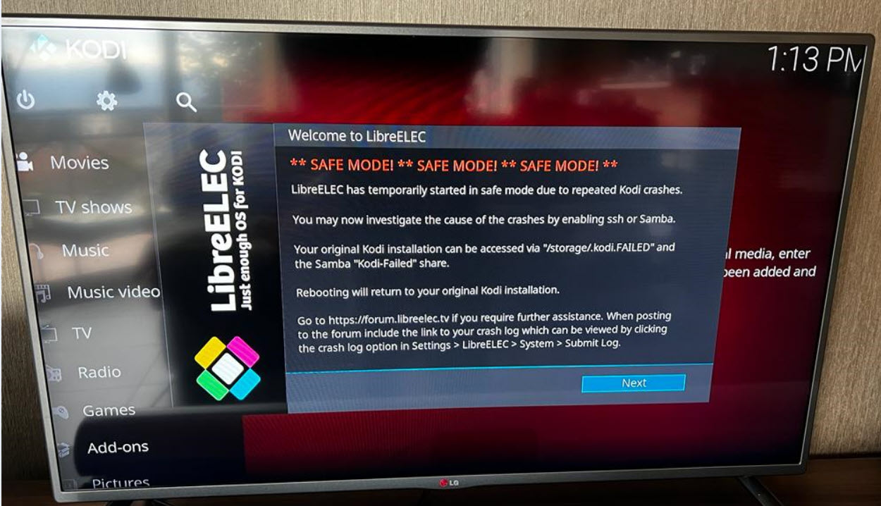

    Several times when i boot my LibreElec machine, i'm stuck in SAFE MODE and need to reboot to work again.
    You can see since my first setup how many times it fails :
    Here is my latest kodi_crash.log.
    As you can see I use the database configuration with an external MariaDB which is still in experimental but i never had any problems with this.
    The MiniPC I use to run LibreElec is H31G.
    If someone finds my problem ?
    Thanks !
  • Nothing stands out, but the most common cause of unexplained crashes is add-ons. So start with a clean install and add things back in small changes until either everything works or you can pinpoint the change that introduces the problem.

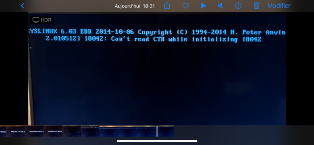

  • I setup a new KODI in a new SSD drive and after several on/off I have the same problem without plugins etc ...
    I noticed something when it goes in SAFE MODE at kernel boot :
    When i googled i found this :
    This message can be safely ignored. This occurs due to the Linux Kernel unable to locate any PS/2 controller.
    Do i need to try to set this on boot in the grub ?
    quiet splash nomodeset
    set timeout="0"
    set default="LibreELEC"
    menuentry "LibreELEC" {
            search --set -f /KERNEL
            linux /KERNEL boot=UUID=C9FE-B3B2 disk=UUID=046048be-ef87-4380-b66f-f155274b5c7f quiet splash nomodeset
  • The message that appears on-screen is indeeed harmless and can be ignored. No harm in adding nomodeset to the boot config .. but we don't use grub unless it's a 32-bit BIOS (as indicated by the SYSLINUX header in the pic). Similar place to modify, but not actually grub.
