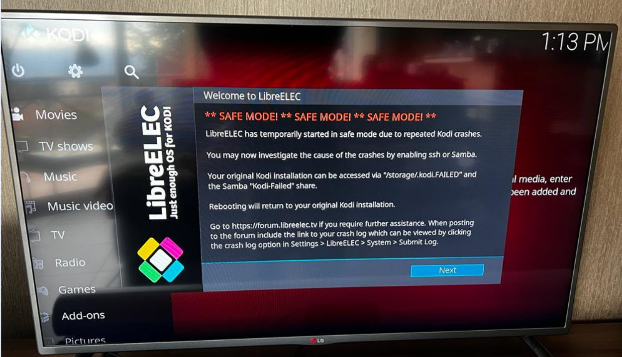

    I think i found the bug !
    I hadn’t this problem with previous Librelec (<= 9)
    So first i need to explain how i use my LibreElec machine. I use a software for my home automation (Jeedom). When i want to watch TV i just say to my Alexa « zap to channel X ».
    - it triggers a Wake On LAN on my LibreElec machine
    - it tries every second to ping the response of the API on 8080 port
    - when it pings it switches to the desired channel with the API
    The problem was i guess the « hammering » every second.
    I change this to try every 5 sc after 25 sc of booting and now it takes maybe fewer seconds to switch the channel after booting, but it does not reboot in Safe Mode anymore.
    So is there something new with the LAN interface and the API in this new version ?
    Thanks for the support :)
    I setup a new KODI in a new SSD drive and after several on/off I have the same problem without plugins etc ...

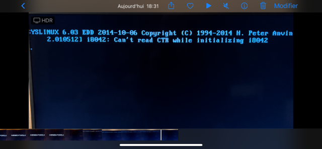

    I noticed something when it goes in SAFE MODE at kernel boot :
    When i googled i found this :
    This message can be safely ignored. This occurs due to the Linux Kernel unable to locate any PS/2 controller.
    Do i need to try to set this on boot in the grub ?
    quiet splash nomodeset

    Hi !
    Several times when i boot my LibreElec machine, i'm stuck in SAFE MODE and need to reboot to work again.
    You can see since my first setup how many times it fails :
