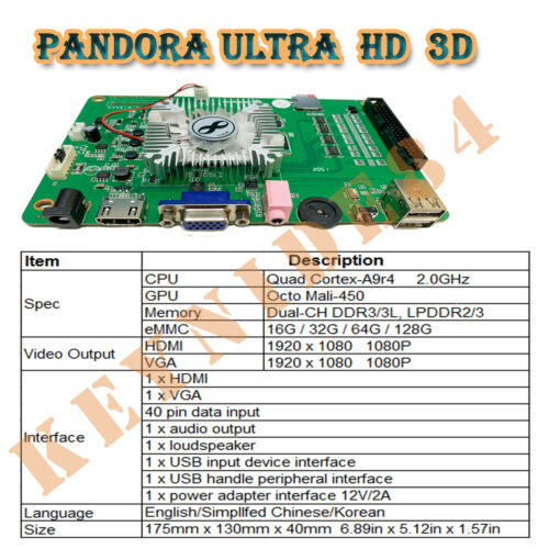

  • Hello, i bought yesterday a pandora box but i dont know what amlogic is.
    I think that is a s912.
    can you help me please?
    The number in the motherboard is rxj1909-MB-v06
    thanks!
    screenshots (same than mine)

    i put 3 photos that are the same than my machine
    and thanks for your help!
  • Pics show a random circuit board with an assortment of standard connectors; it could be anything. The sole useful bit of info is on the chip under the heatsink. Unless you share that I can only make blind guesses, and I guess your box is not supported.
  • I found something: Pandora's Box 3D 8000 Games Arcade Console Gameboard JAMMA Motherboard DIY PCB
    The S912 is not a Cortex-A9, but the S802 and S812 are. Anyway, the heat sink is held in place by a spring-loaded strap, so why not take it off to check it out? The type is inscribed on the top of the SoC.

    finally i take it off and see that is a 812
    but is very weird because have the same folders and can add games like a s912
    i mean, in the sd, it have the same folders (2d, 3d, downloads, roms, etc) but no the s812 typicals
    any idea?
    thanks guys!
  • The type of connectors and components used and layout style of the PCB looks older to me, so I'd put my money on it being an Amlogic S812 device. All the Amlogic S912 boards I've seen use PCBs with more layers and much more dense population of smaller components. Another clue / hint on age will be MMYY or YYMM date codes on components, e.g. RAM chips. There's a 1502 printed on the PCB which would be Feb 2015 which would also align with S812 as S912 devices started to show up in 2016. If it genuinely has a Mali T830 chip; it's a HiSilicon Kirin board, but I think documentation typos (or even the wrong documentation in the box) are more likely.
