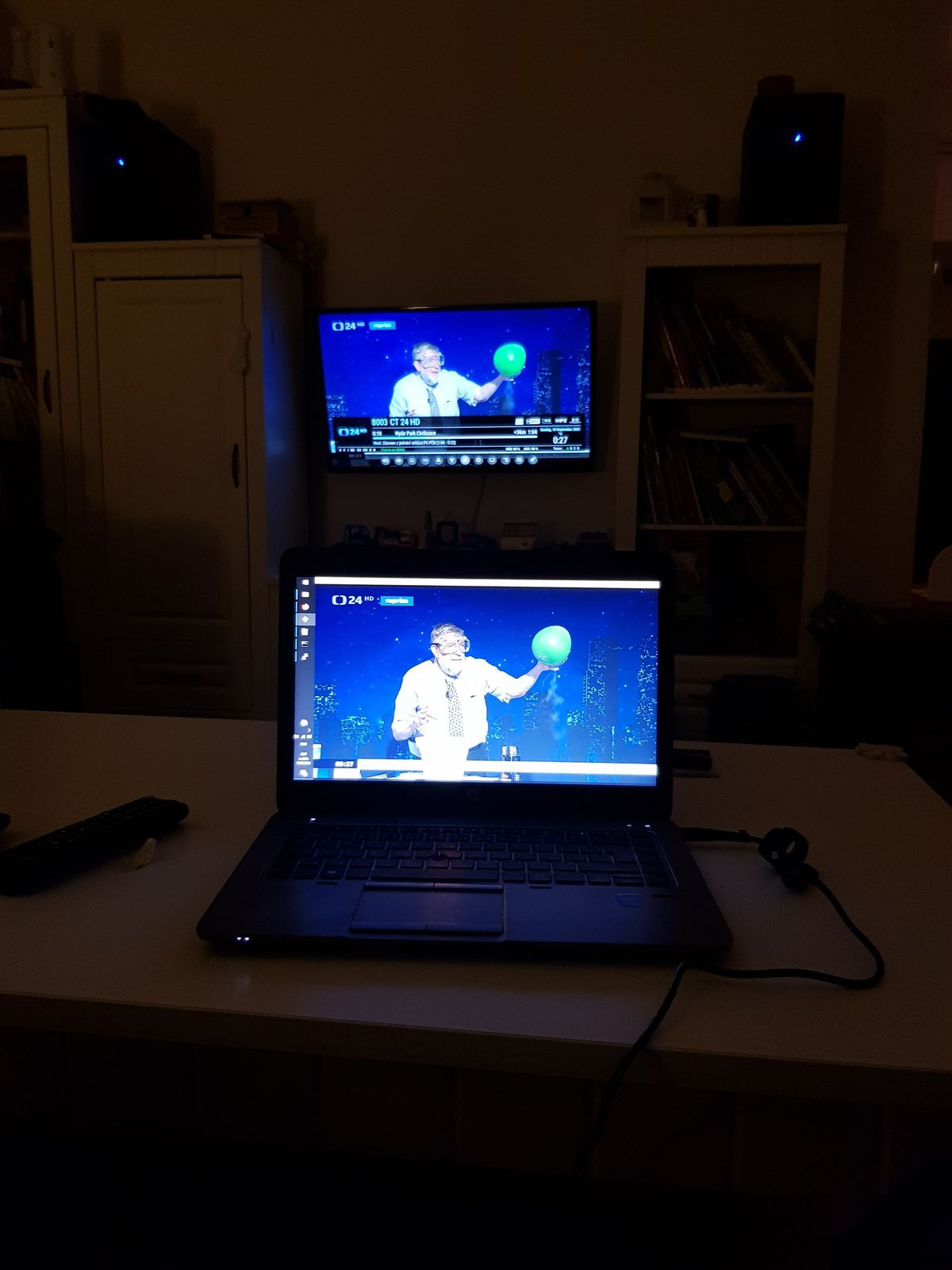

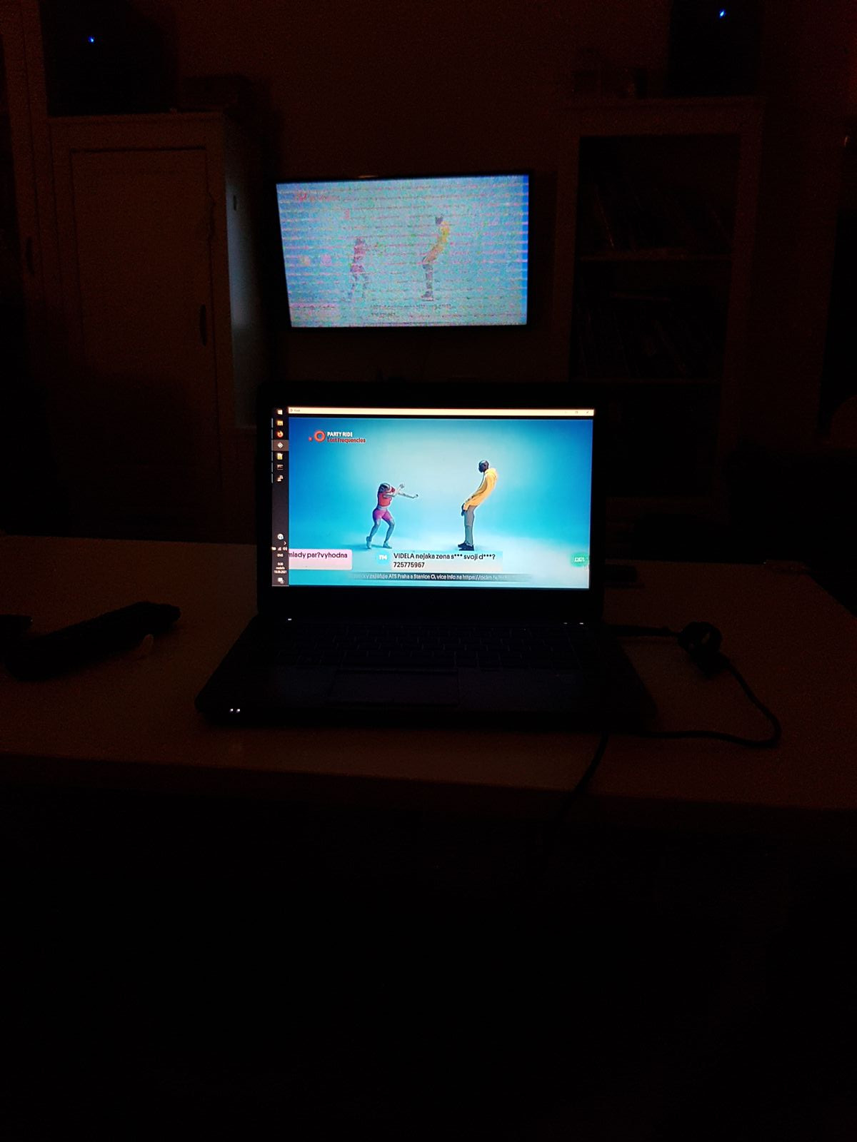

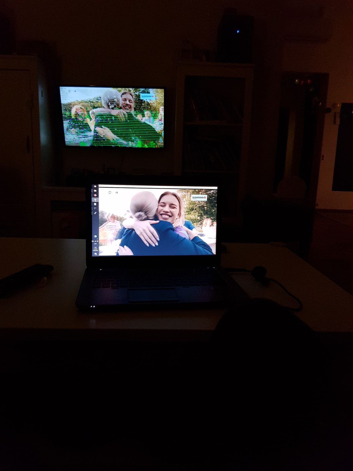

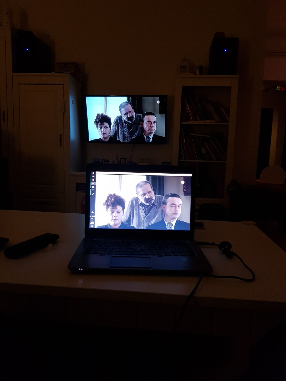

I'm having weird issue with HC4 image. I have sundtek skytv ultimate 6 usb stick, which I moved from old LE krypton x86 box to this new HC4. I installed the tvheadend 4.2 server and pvr client. I copied the config, as I was lazy to configure it fresh and I immediatelly noticed problems. Some channels don't start at all, some freeze the HC4, some got some weird scrambled green pattern, others like old weak analog signal overlay, but then there are channels without issue. I thought it's the sundtek driver issue. But then configured kodi on my windows laptop with tvheadend pvr client pointing to the HC4 box TVH 4.2 server and the issue got reduced to two states. Channel doesn't start, or it starts fine. So it's not the sundtek driver or it isn't sundtek driver issue only. If you let me know what to check or report, I'll.

The hardware video decoder in the mainline kernel is a bit rough, so these are known issues with no specific fix in sight. You're probably better off using CE on an HC4 at this time.

On a laptop I would assume there are no hardware decode issues (not impossible, but much rarer). On the HC4 if you want to eliminate the VDEC being an issue (the green lines is a known issue) you can go into Kodi settings > Player > disable "Allow using DRM PRIME decoder" and then Kodi uses ffmpeg software decode. The HC4 should have enough grunt to handle software decode with 1080p media.
from the pictures above its a decoder issue not a dvb issue
maybe due borderline quality strength at the dvb signal and the decoder can't handle it

I want to point out (again) that the colour distortions and green lines in the images in post #1 are due to the current Amlogic hardware video-decode driver. It is not in a good state. It generally works okay with older Amlogic hardware and less okay with newer. The driver is in staging and is effectively unmaintained for 2+ years, and it predates SM1/S905X3 hardware being released. There is also a dependency on the codec and version of firmware blobs being used (lots of variables).
