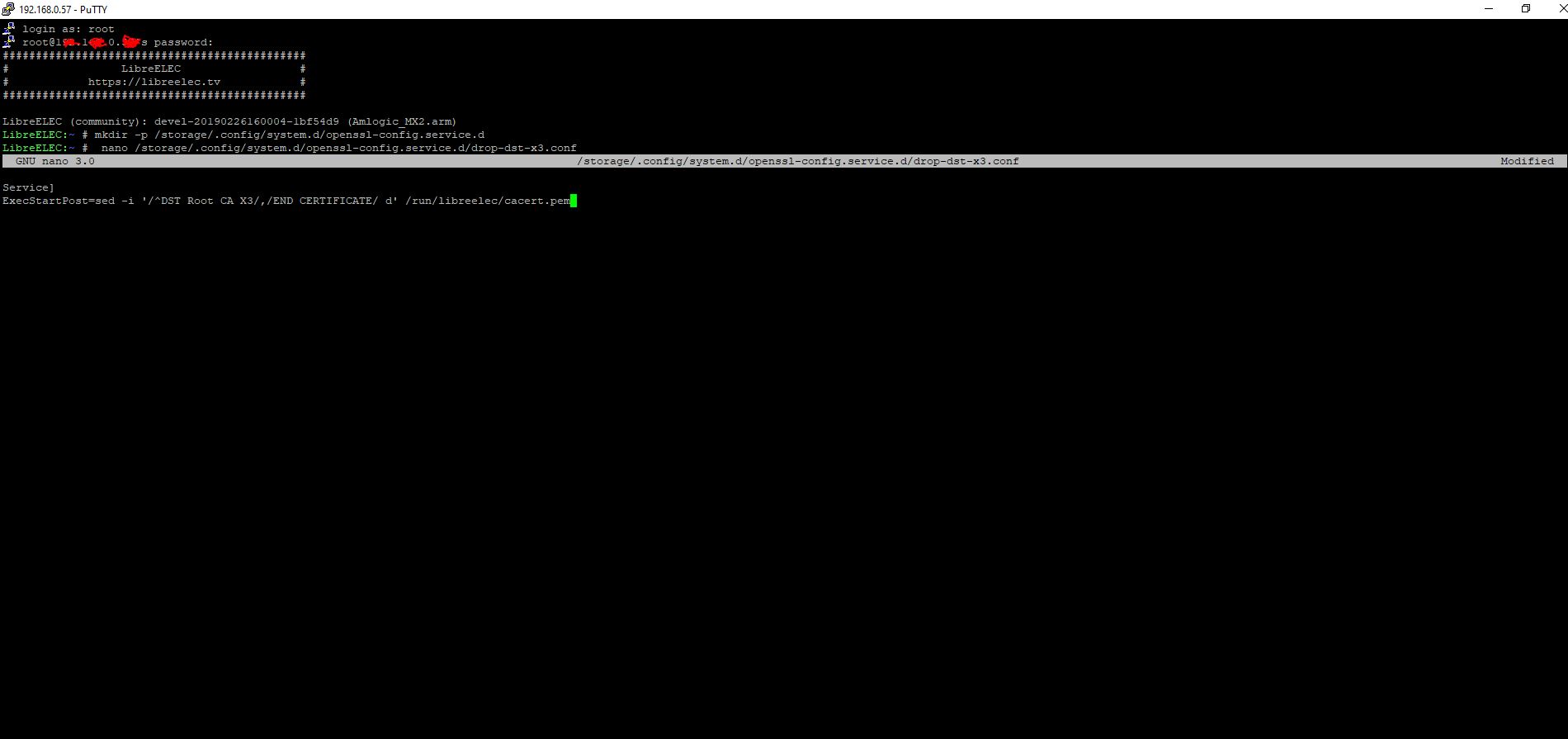

  • Is easier to understand
    1.create folder
    mkdir -p /storage/.config/system.d/openssl-config.service.d
    2.create config
     nano /storage/.config/system.d/openssl-config.service.d/drop-dst-x3.conf
    3 create file, add line
    Service]
    ExecStartPost=sed -i '/^DST Root CA X3/,/END CERTIFICATE/ d' /run/libreelec/cacert.pem
    system restart /reboot

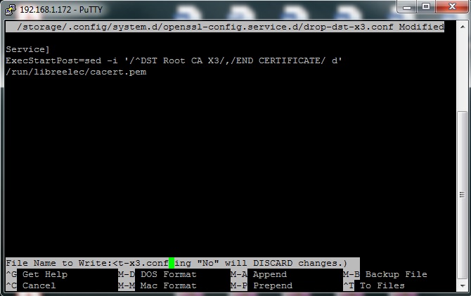

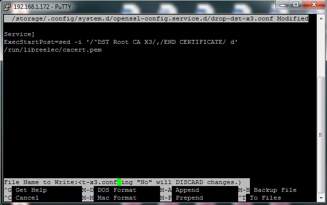

  • Hello,
    had no luck yet.
    After executing all the steps above and pressing 'Y" to save , i see that Putty is asking something about filename, what should i press then?
    Edit:
    I just press Enter and it seems ok.
    Then i checked with FTP and i see that the drop-dst-x3.conf file is created in correct directory.
    I reboot but nothing is affected, all add-ons fail to update.
    Edit 2:
    Problem solved, i had to update Libreelec as well to latest, after that the fix above worked!
