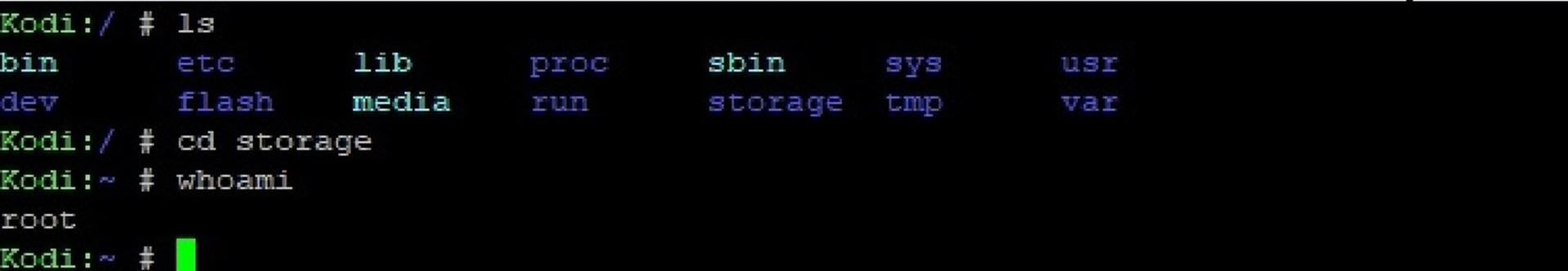

    You don't need to install sqlite3 since it is already installed/present in the OS. And you don't need to prefix commands with 'sudo' to run them as root since you are already the root user. TL/DR; Just run the fix commands.

    Enable SSH and use PuTTY (Windows) or the native SSH clients on Linux/macOS to connect
    I managed to connect with PuTTY and found the video database at "/storage/.kodi/userdata/Database". How can then edit the database file?
    When I try to install sqlite3 following the link that you said I get an error message that says that "There is no working sudo" ¿?
    If I copy the line without "sudo" another message says " There is no working "apt-get". It seems that these commands do not work in my LibreELECT 9.0.2 installed in an ODROID-C2?. What are the correct comands then?

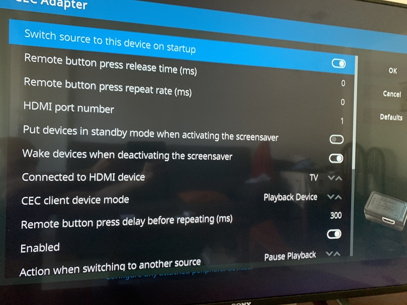

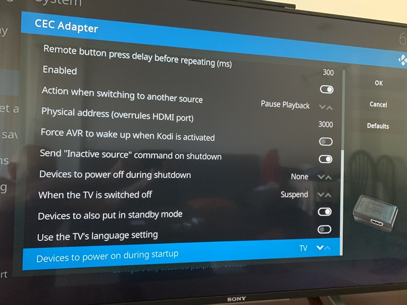

    After some changes on the Multimedia equipments at home Kodi don't starts on my O-DROID C2.
    During the startup you can see the LibreELEC 9.0.2. logo as usual but later the screen becomes dark and you only see a black arrow on it. As I have a Logitech keboard connected I can move the arrow around the screen but that's all. Kodi never runs.
    I formated and installed again LibreELEC 9.0.2 in the eMMC card unsuccesfully. Later I released the eMMC and connected an microSD with a fresh installation of LibreELEC 9.0.2 with the same result so, unfortunatelly I suspect that can be a hardware problem.
    Any idea? Can I do any additional test?
