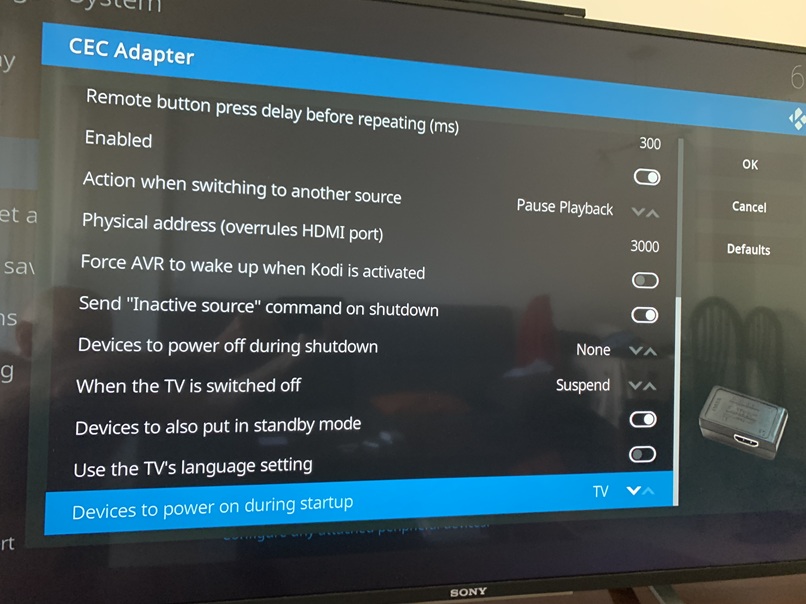

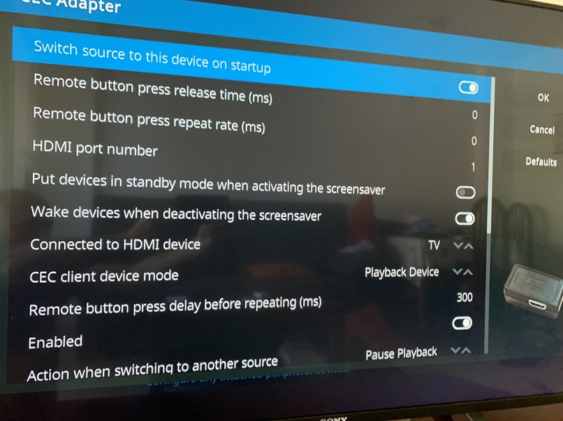

  • Here we go again: I compared the LibreELEC 9.0 CEC control settings with the LibreELEC 13.0 ones and I set all the parameters and switches at almost the same values but the problem remains. The only difference is the Physical address that overrules the HDMI port. While in 9.0 is 0, if I set to 0 in the 13.0, at the next startup has changed to 3000. Of course, I'm using the same HDMI input in both cases.
    If I use the Odroid-C2 remote control I can startup the LibreELEC without problem so, it seems that I will have to use this remote control to just startup Kodi :(.
    Anyway, here are two pictures of the 13.0 CEC settings. If someone has some clue about how to to solve the problem, please let me know...
