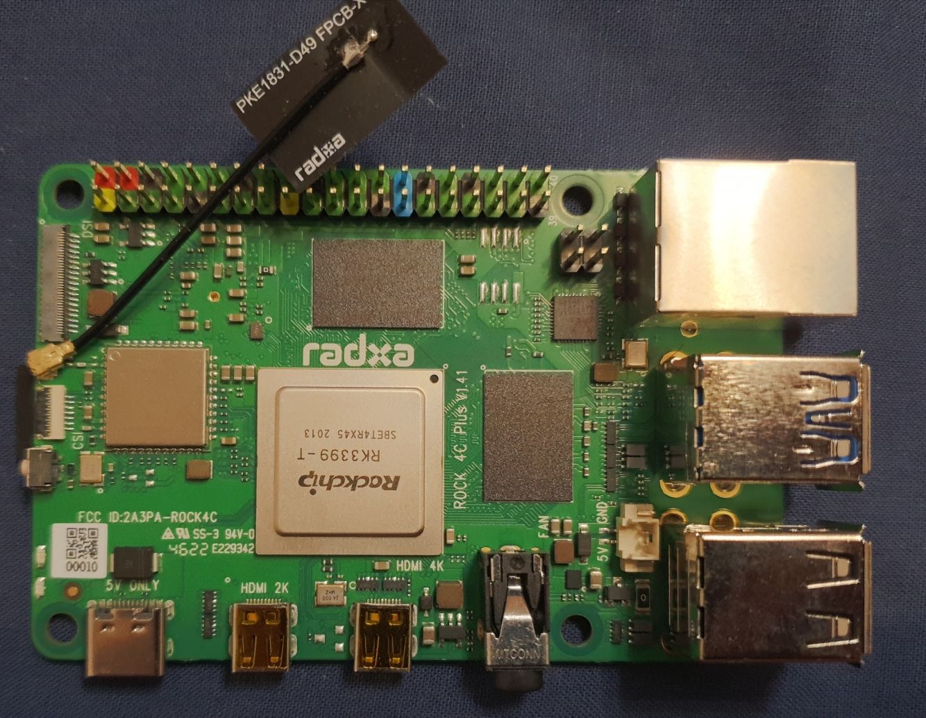

  • Wuk-jvi please share pic of the board.. unfortunately radxa is unreliable because with the same revision of this board it mounts different rams that are not compatible with the uboot currently used in libreelec. unfortunately it happened to me too. the only solution if this is the problem is to go back to the proprietary bootloader
  • Sorry for not answering sooner, I had to get serial cable, and then I did not have time.
    Now I'll have some time to play with this.
    It's later version of the board - v1.41.
    For some reason I cannot upload bottom picture of the board, I'll try in another message.

  • You have the same problem as me. As described here, unfortunately a fake version of the board is being sold (I can't tell you if it's due to Radxa or the distributor). In fact, some voltage regulators are missing (I presume) and the RAM is different. Rockchip's proprietary bootloader recognizes them and in fact, from the serial port output, the clock set in the distro that works(dietpi) is 666MHz. The Libreelec bootloader (which is the upstream one) for this board sets it to 800MHz as it should be if everything were according to the official specifications.
