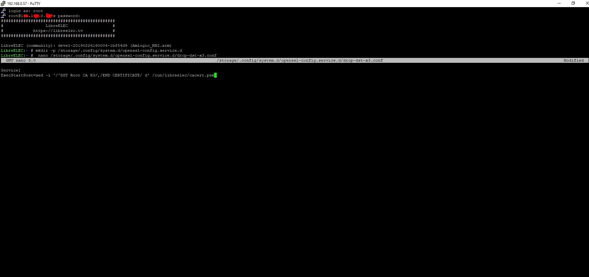

    I've had issues like this when the permissions have been changed on /storage, I'd do the 7.95.3 factory AV "toothpick" install then, do the tune2fs with SSH (this will also break /storage if not done) and upgrade to 9.0.2 (just copy the tar archive into /storage/.upgrade and reboot)
    Thanks, yes I have tried multiple times, it just will not work with kodi 18 anymore :(
    EDIT: Finally fixed, it was the the same issue as Cannot Install/Update Addons afterall
    I currently have 9.0.1 & kodi 18.1 running since this was the combination that worked well. I manged to get Samba working finally but this is to do with the SMB setting I played around with.
    I attempted the instruction on the other thread, as this sounds like my issue - zip files work - but not from repositories and no skins installing
    EDIT: I have given up and will just put kodi17 on this box and use for samba, no idea why 18 wont work suddenly after years.
    oh well, pity as box has been good and still works.
    I've had this box running well for a few years now with 9.0.1 & kodi 18.1, but I did a reset/clean this week, it works fine with 7.95.3 & kodi 17, as soon as i update to 9/k18, I lose all ability to instal, cannot even download a new skin, no SMB , just no connections.
