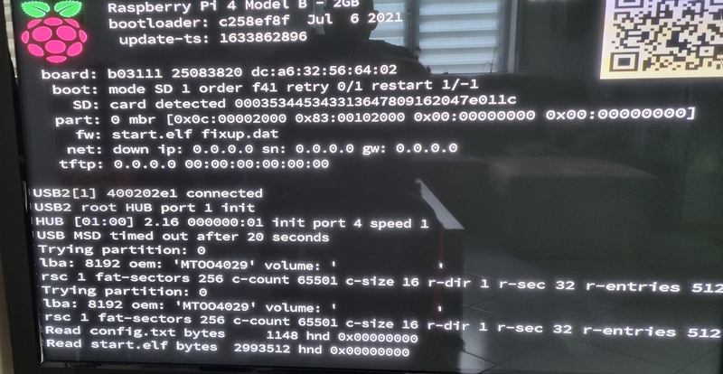

Also with the "LibreELEC-RPi4.arm-11.0-nightly-20211010-4ec2af6.img.gz" my Raspi 4 does not boot.
The start.elf is found (see attachment), then comes the coloured square and then a black screen. That was it.

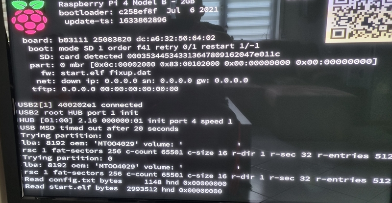

Please open a new thread for this, because your original issue is different. Make sure you are using an HDMI 2.0 or 2.1 cable (especially if you have a 4K TV connected). Try to login by SSH when black screen appears, and post a link to a kodi.log.
