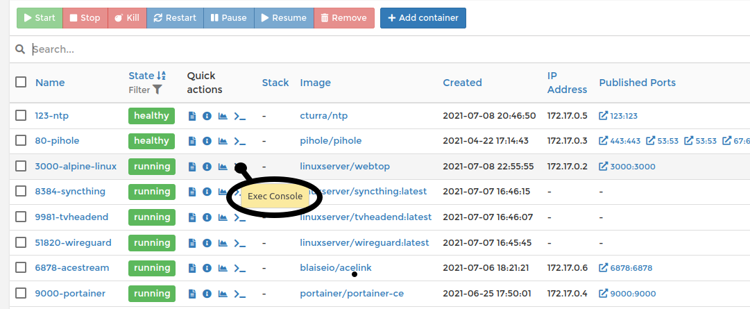

  • I don't know where the container is saving data if it is at all. I thought it would be in addon_data.
    This is easy to fix. Install docker portainer and click on "Exec console" to enter the minecraft directory tree. If you need to access a directory from LibreELEC then delete the minecraft container and run it again adding the parameter "-v <libreelec-directory>:<minecraft-directory>".

  • This is easy to fix. Install docker portainer and click on "Exec console" to enter the minecraft directory tree. If you need to access a directory from LibreELEC then delete the minecraft container and run it again adding the parameter "-v <libreelec-directory>:<minecraft-directory>".
    I was able to connect to the server! I just had to hit recreate in portainer and EULA got accepted.
