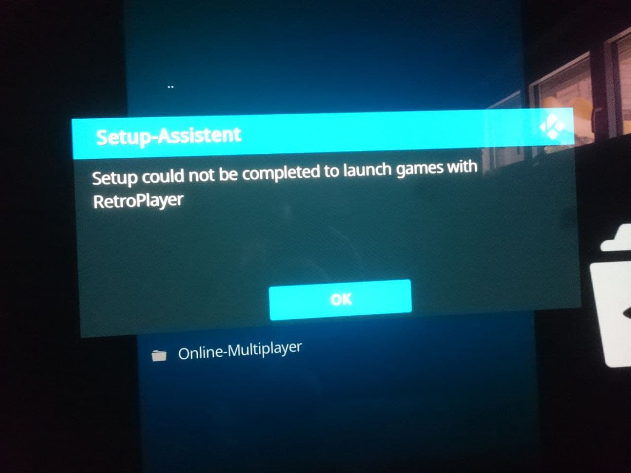

    Then, after installing all emulators and downloading all game lists, on the very end of the wizard, the setup assistant showed up "Setup could not be completed to launch games with RetroPlayer" which gave me a bad feeling again. And indeed I was not able to run most of the games. So I went through IAGL addon settings and mentioned that the "archive.org" account I have inserted on the wizard was not being saved so I tried to insert it via the IAGL addon settings manually again. Then I checked for "account confirmation" (I don't remember how exactly the option is called within the IAGL addon settings) and got the message that the account was found successfully.
