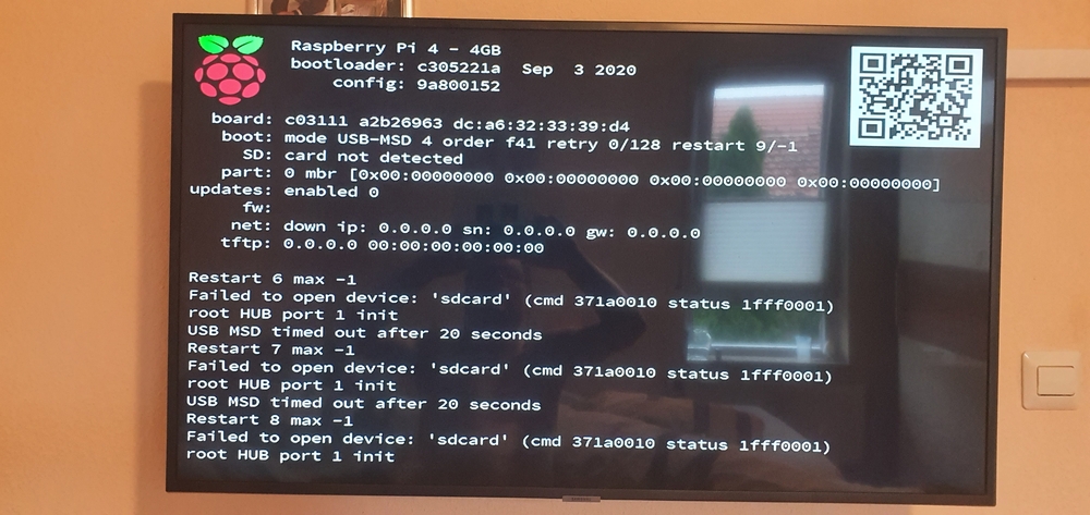

What does not work is booting from a Samsung Portable SSD.
Yes everything up to date.
No it is NOT - at least your bootloader is a bit outdated, the latest stable release is dated 2021-04-29 and beta 2021-05-19 (rpi-eeprom/release-notes.md at master · raspberrypi/rpi-eeprom · GitHub).
It looks your portable SSD is not detected, it could be due to incompatibility with RPi's bootloader or due to insufficient power.
Please note that RPi 4B has a quite low power limit on USB ports (even though you have a good power supply) so an external power for attached external disks is a good option.
Also try connecting the SSD to USB 2 ports.

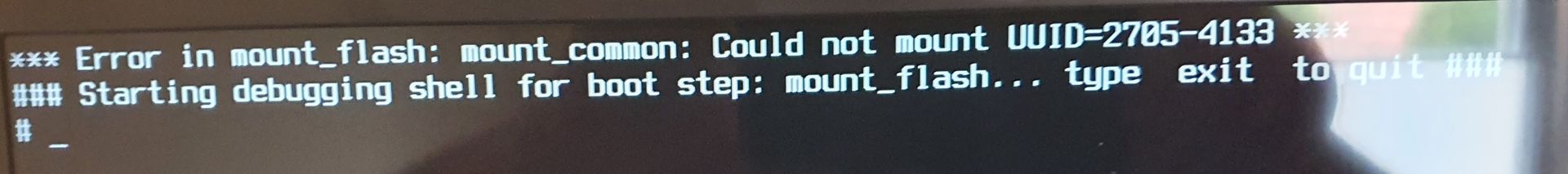

Booting does the Raspi now with the ssd, but it always hangs in the same place.
Try to install the latest LE 10 nightly: LibreELEC-RPi4.arm-10.0-nightly-20210604-f6b7711.img.gz

After the next boot the system complained that the firmware is missing.
Then it did not boot at all.
From my SanDisk Ultra USB 3.0 16GB the Raspi does not want to know anything.the is not found at all.
What else can I try?
Translated with DeepL Übersetzer - DeepL Translate (free version)
Use another external drive, properly powered.
