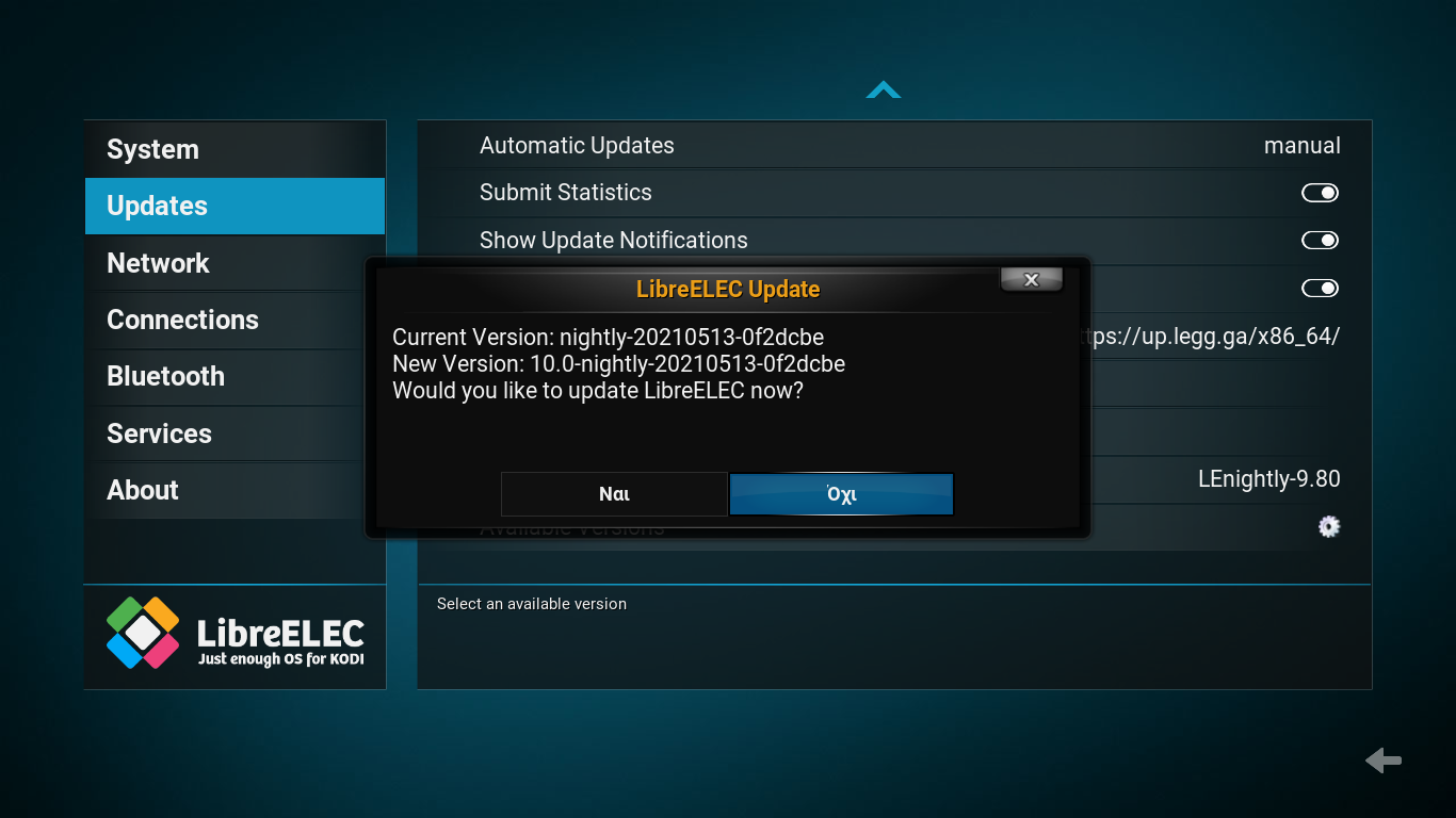

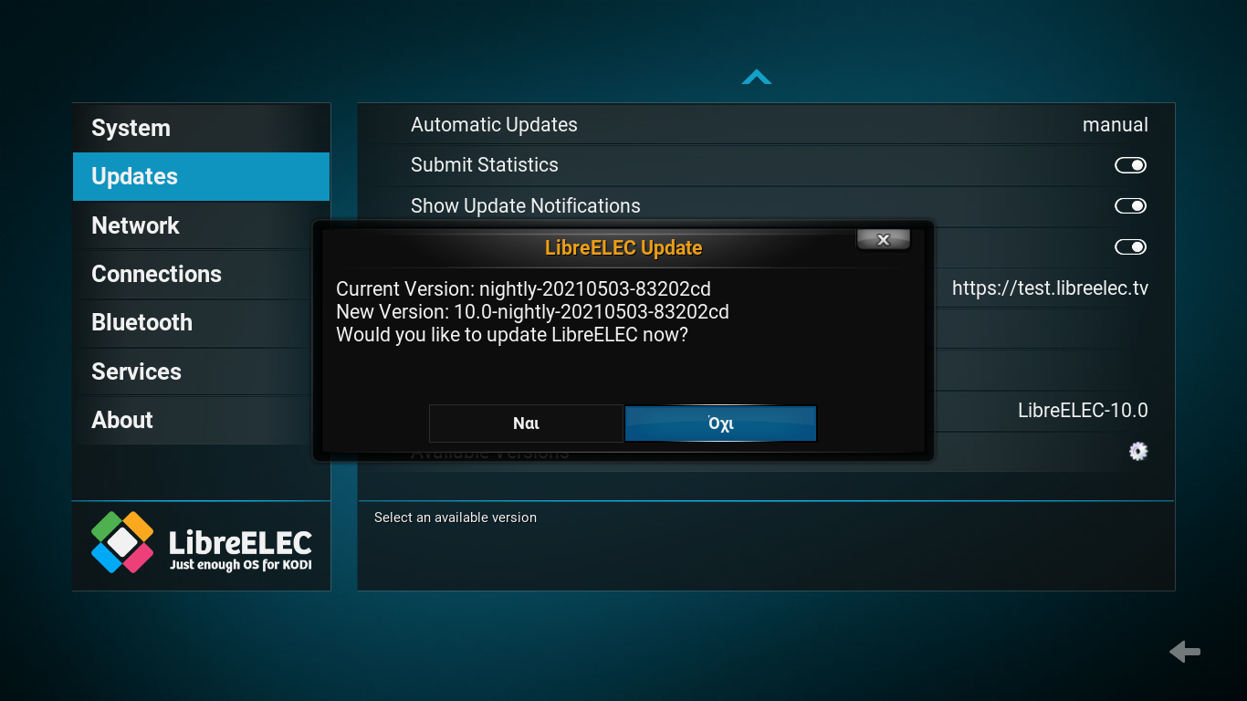

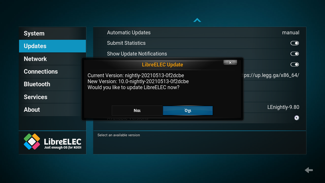

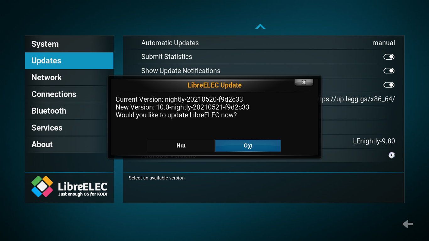

  • As I am still waiting for releases.json to be renewed and include today's nightly upgrade (1da9953, after days with no new nightlies due to no new commits in github), I would like to report 2 things.
    1) For some reason and as seen on the screenshot, the update... mechanism thinks that the installed version is different/older than the one in the repo, although they are the same. That "10.0-" part at the front seems to mess things up.

  • jim_p The shown "New Version" string is defined by the update file.
    flubshi To get the expected result try:
     @@ -1,6 +1,6 @@
         "LEnightly-9.80": {
    -        "prettyname_regex": "^LibreELEC-.*-([0-9]+\\.[0-9]+\\-.*-[0-9]+-[0-9a-z]{7})",
    +        "prettyname_regex": "^LibreELEC-.*-[0-9]+\\.[0-9]+\\-(.*-[0-9]+-[0-9a-z]{7})",
