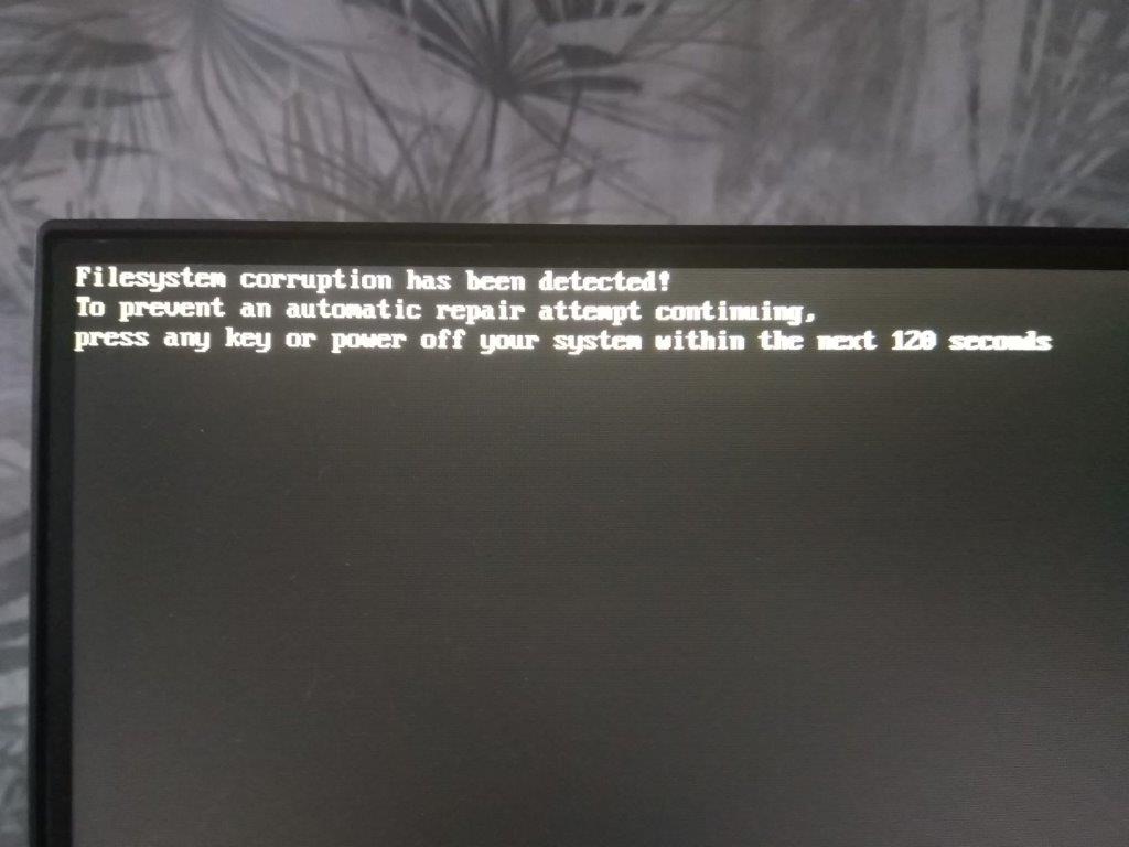

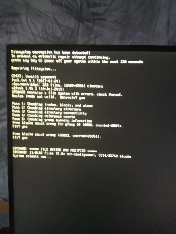

Hi there,
I'm using a brand new Pi 4 model B with 8Gb of memory in combination with a class 10 16Gb SD Card.
I used the Libreelec download for Windows to prepare the memory card.
After preparation I got the file system corruption error and after I contacted my supplier I received a new card. Unfortunately this was not fixing the issue, I keep on getting the same error, see attached screen shots. I also installed the same Libreelec software on an old spare 2Gb SD, which is working as it should, no problem, only slow as it is probably a class 2 or 4 card.
I tried several options for installation (2 different PCs, the Libreelec software but also the PI Imager), all giving the same result. I also did a low level format of the card in between.
Based upon this information my first thoughts were the 2nd card was also defect, but that was too much of a coincidence to me, so my next step was the installation of Raspberry PI OS (32-bit) on the same card using PI Imager. This all works fine, no errors on the card, the OS was updated, I could start Thonny, run a small Python program etc.
Do you know whether there is an issue with the mentioned configuration? Or do you have any alternatives I can try?
