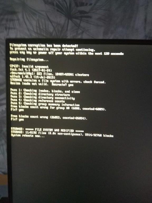

Just an update that my issue is solved.
Today I bought a 16Gb SanDisk Ultra microSDHC Class 10 card and retried from start and to my big surprise it is working!
So I guess there must definitely be something wrong in my previous 2 cards...

You could try Etcher to write the microSD. Etcher will check for errors after writing, and it's approved to work with LE.
Thanks for your prompt reply, tried Etcher, but is giving me the same error, although the Etcher validation was successful.

Hi there,
I'm using a brand new Pi 4 model B with 8Gb of memory in combination with a class 10 16Gb SD Card.
I used the Libreelec download for Windows to prepare the memory card.
After preparation I got the file system corruption error and after I contacted my supplier I received a new card. Unfortunately this was not fixing the issue, I keep on getting the same error, see attached screen shots. I also installed the same Libreelec software on an old spare 2Gb SD, which is working as it should, no problem, only slow as it is probably a class 2 or 4 card.
I tried several options for installation (2 different PCs, the Libreelec software but also the PI Imager), all giving the same result. I also did a low level format of the card in between.
Based upon this information my first thoughts were the 2nd card was also defect, but that was too much of a coincidence to me, so my next step was the installation of Raspberry PI OS (32-bit) on the same card using PI Imager. This all works fine, no errors on the card, the OS was updated, I could start Thonny, run a small Python program etc.
Do you know whether there is an issue with the mentioned configuration? Or do you have any alternatives I can try?
Thanks in advance,
André
