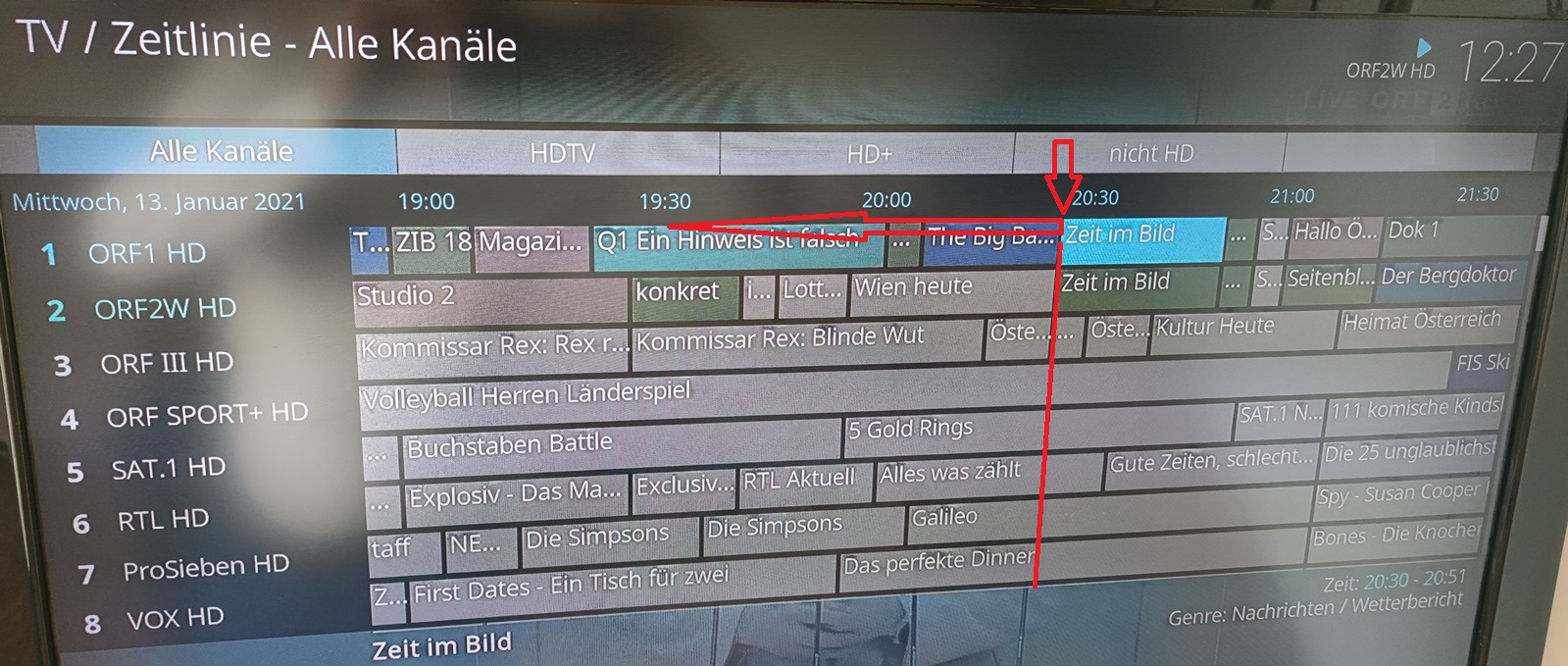

    After each change from summer to winter/normal-time my EPG is not longer aligned with the correct time. Insted programs that start at 19:30 are shown +1h means 20:30. (During summertime the EPG is shown at the correct time)
    So each line of the EPG overview is shown one hour later. At the TV programs the EPG is also shown misshifted, but corrected if I tune into this program. Anoying.
    The TVheadend server is set to the correct timezone (CET/CEST) automtically via NTP and the client to the correct regional setting. (also via NTP)
    The time in the upper right corner is correct.
    This problem occures only on my Libreelec/Raspi systems, not on the Windows/Kodi-systems. There the EPG is aligned correct.
    Any hints to get the right-aligned EPG during wintertime on the libreelec-systems?

  • In addition to the language, check the location of your country and the date and time settings in Kodi. You don't have to do anything else. The EPG will appear in your local time.
  • The regional setting are set to Europe/Vienna (correct). - same on Windows PC.
    I'm wondering why the EPG is correct at summertime and wrong at normal time.
    -Tbone4711
