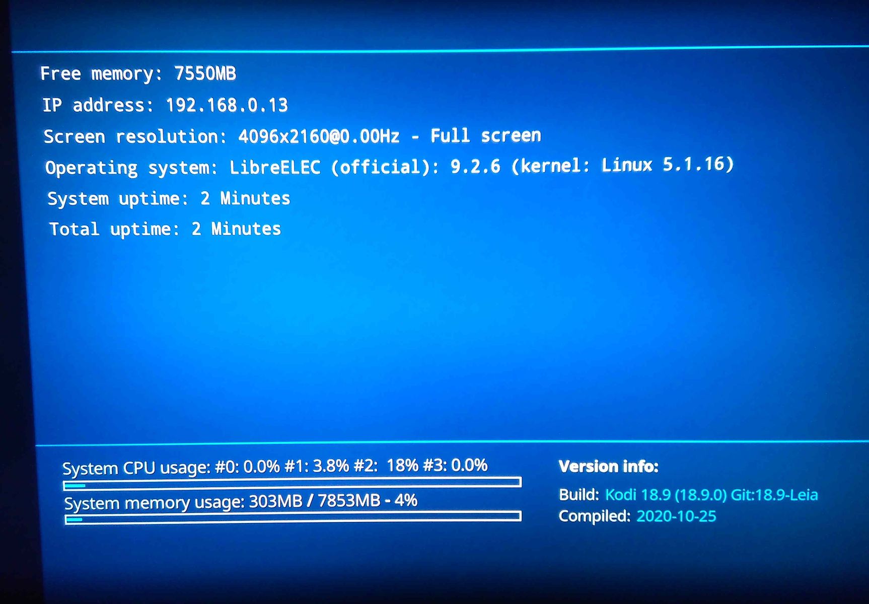

  • Tried both soft and hard reset to no avail, what I have is this.
    so I went to an older TV and powered up, Kodi switched to a lower resolution and the option weren't greyed so I set it to 1090p 60 frames and HDMI instead of default monitor. Went back to the 4K TV and it went straight back to what's in the screen shots.
    Something has changed as I was using libreelec at a lower resolution fine up to now. Is there a setting that I'm missing to stop it detecting the resolution and refresh rate???

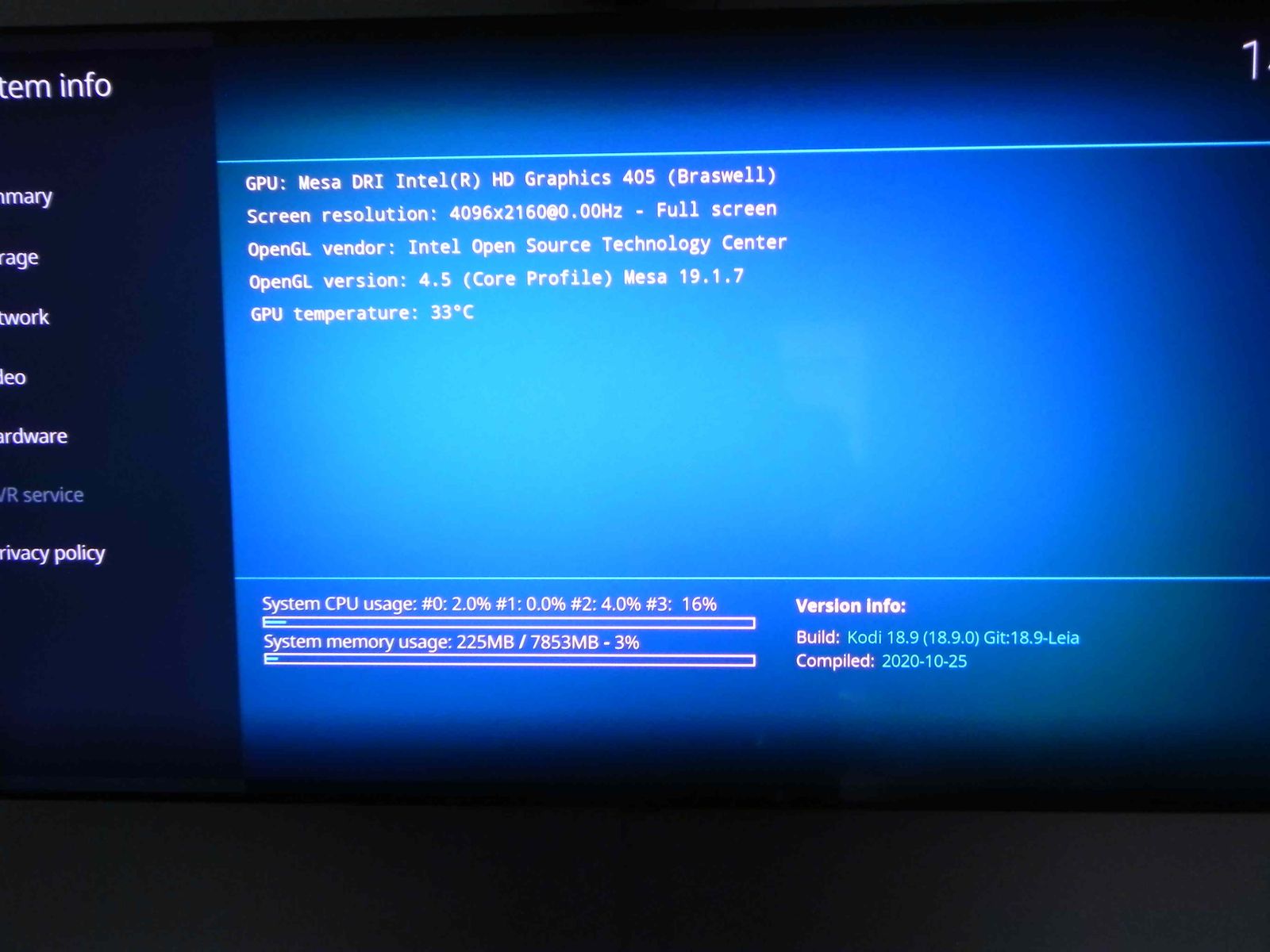

  • What does it say on the Graphics page, perhaps you can show a screenshot of that as well.

  • Is this the info, if not can you point me where to find it please
    Also http://ix.io/2ltx
    As this is a recent thing could it be a bug in the latest version? Can I revert to an older build. I also tried swapping to an older slow HDMI cable but that didn't help, it just wants to see the 4K display with no refresh rate shown.
