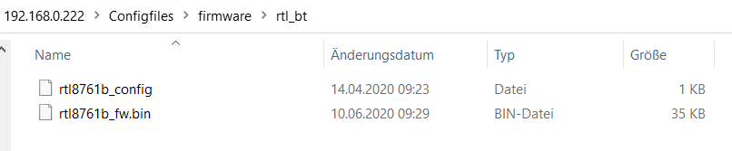

  • Code
    mkdir -p /storage/.config/firmware/rtl_bt
    wget -P /storage/.config/firmware/rtl_bt https://git.kernel.org/pub/scm/linux/kernel/git/firmware/linux-firmware.git/plain/rtl_bt/rtl8761a_fw.bin
    The config file is optional.

  • Oh, perfect. Many thanks. I download LibreELEC-Generic.x86_64-9.80-nightly-20201217-76a852d.img.gz and the firmware.
    Does the update go inside /storage/.update?
    Does the firmware go inside /storage/.config/firmware/rtl_bt?

  • If you are still using a RPI2 you do need LibreELEC-RPi2.arm-9.80-nightly-20201218-76a852d.img.gz
    Yes
    Yes
