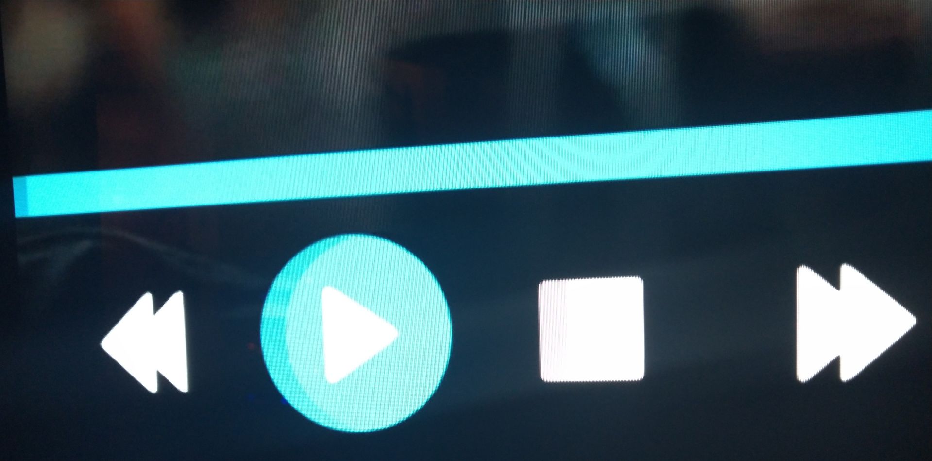

  • Hi, I Am on 10.85 / S912 i can see strange behavior but on Play screen only. Menu like information, bookmarks etc. looks duplicated (with small offset). External subtitles are also affected.
    Known problem where something in the OSD plane isn't calculated correctly. If you, e.g. put the debug overlay on/off/on/off .. each time you make it visible it will shift by 1px. It's may be related to the pink line (also 1px suggesting something is misaligned) but figuring out that kind of thing in code needs someone that can read the code better than me. It's in the list.
