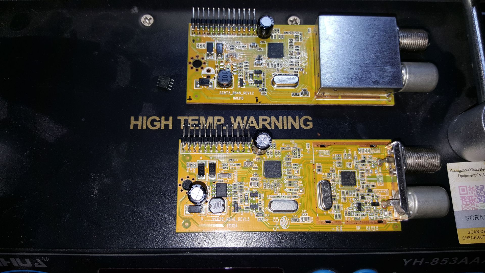

    I just ordered hot air station - nothing fancy but should do the trick.

    This one here is extremely HOT straight away - i know same as yours DC-DC converter but i won't be able to replace it without hot air - too small, too many legs;)
    I still might buy it and try to replace it but i'm 99% sure i will fail. Just bought 2pcs from Ali so have planty of time to buy hot air station;)
