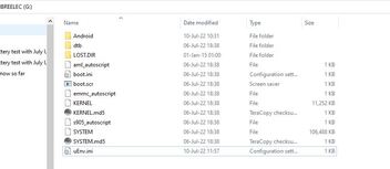

I am using Alfawise H96 pro plus, flashed LibreELEC-AMLGX.arm-10.85.0-box.img.gz with RUFUS tried all the GXM DBTs in the uEnv.ini but my device cant boot with SD and reboots straight to Android EMMC... not sure what I am missing here.
This is what I got on the card
and my ini file where I tried all the DTBs.
dtb_name=/dtb/meson-gxm-s912-libretech-pc.dtb
bootargs=boot=UUID=0607-3755 disk=UUID=dbdec193-7dba-4cb3-9cb5-3ca7de70fa50 quiet systemd.debug_shell=ttyAML0 console=ttyAML0,115200n8 console=tty0
Thanks for helping out!
Damn! Tried the toothpicked and it booted ,weired, all my other distribs boot directly, but let`s see q200.dtb

LE uses different u-boot bootscript, so unless you (re)load it by forcing recovery boot you're trying to use legacy boot scripts which don't see our boot files. You'll need to do the same (for the reverse reason) if you revert back to older distros.
