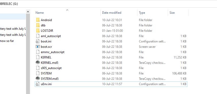

Hello Chewiit,
I am using Alfawise H96 pro plus, flashed LibreELEC-AMLGX.arm-10.85.0-box.img.gz with RUFUS tried all the GXM DBTs in the uEnv.ini but my device cant boot with SD and reboots straight to Android EMMC... not sure what I am missing here.
This is what I got on the card
and my ini file where I tried all the DTBs.
dtb_name=/dtb/meson-gxm-s912-libretech-pc.dtb
bootargs=boot=UUID=0607-3755 disk=UUID=dbdec193-7dba-4cb3-9cb5-3ca7de70fa50 quiet systemd.debug_shell=ttyAML0 console=ttyAML0,115200n8 console=tty0
Thanks for helping out!
Damn! Tried the toothpicked and it booted ,weired, all my other distribs boot directly, but let`s see
q200.dtb
