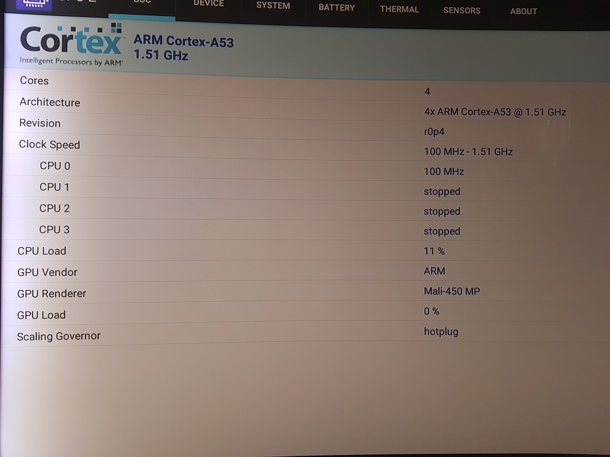

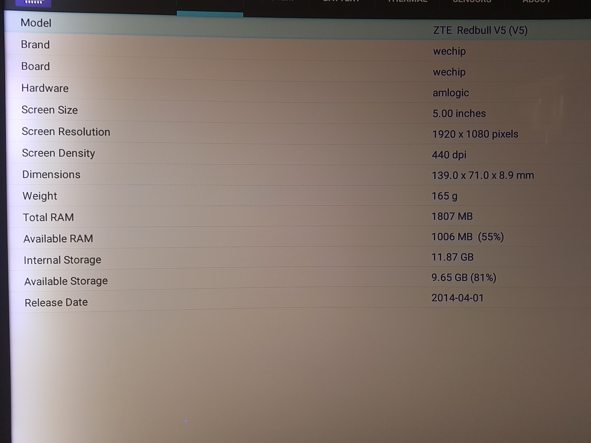

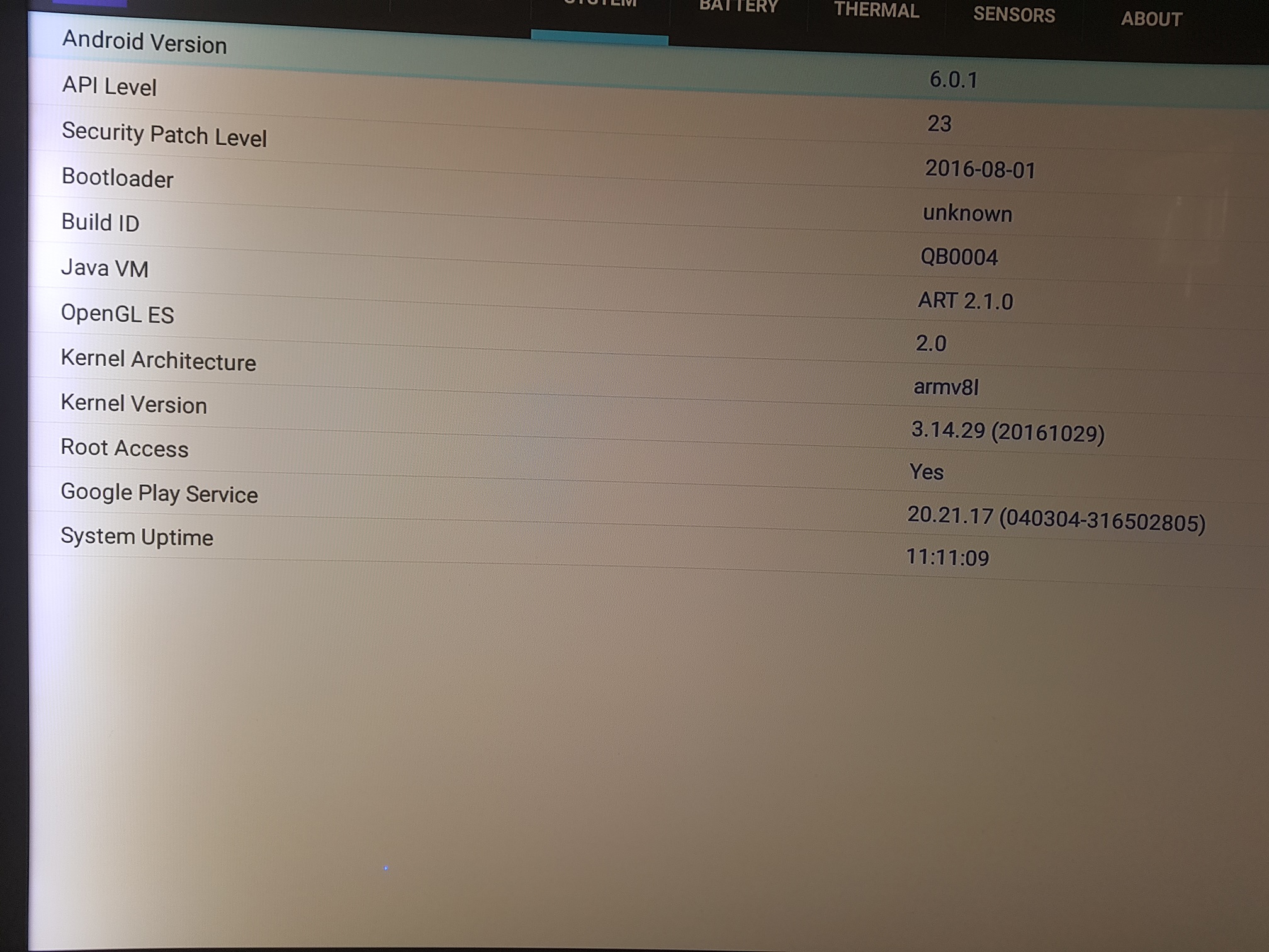

wechip V5 Android TV Box Amlogic S905 X 2
Edit: Android 6.0 operation system. Amlogic S905X CPU, Quad core, ARM Cortex-A53, 2.0GHz. ARM Dvalin MP2 GPU 2GB DDR3 RAM
Thats what I found on the Device.

If it's running Android 6.0 and a Mali 450 GPU it's not an S905X2 device, more likely to be GXBB (S905) or perhaps GXL (S905X). Use the AMLGX "box" image and see if any of the device trees work.
I can`t make it boot from sd card! Reset is in AV hole but nothings happen when hold it pressed and plug in on box, just loading android! Any suggestions? Thanks.
