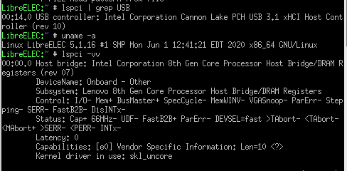

  • My SSD USB drives sit in USB 3.1 Gen2 enclosure, so theoretically the speed should be 10,000M.
    The USB ports on Lenovo M720q are also USB 3.1 Gen2 compatible.
    However, when I run <# lsub -t> the output shows my max speed is only 5,000M
    Edited 3 times, last by bpr323 (July 1, 2020 at 1:05 AM).

  • My LE etc/fstab file has two lines:
    /dev/cdrom /media/cdrom iso9660 noauto,ro 0 0
    /dev/usbdisk /media/usb vfat noauto,ro 0 0
    # blkid returns as per screenshot below
    <removed by admin>
    If etc/fstab holds the answer - how should I fix the current two lines in it?
