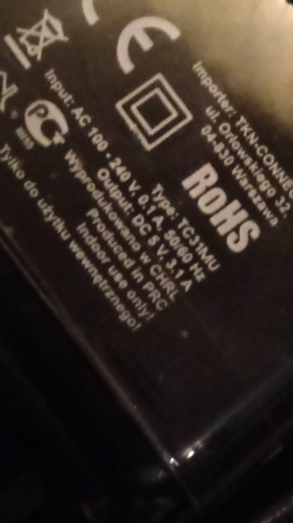

    The only problem is that for some strange reason after 1-2 days I get throttled and this with a power adapter 5v/3.1A that work perfect on rpi 4B - 2G RAM ( no throttled ).
    Next week will test with another new power adapter 5v/3A and another USB stick.

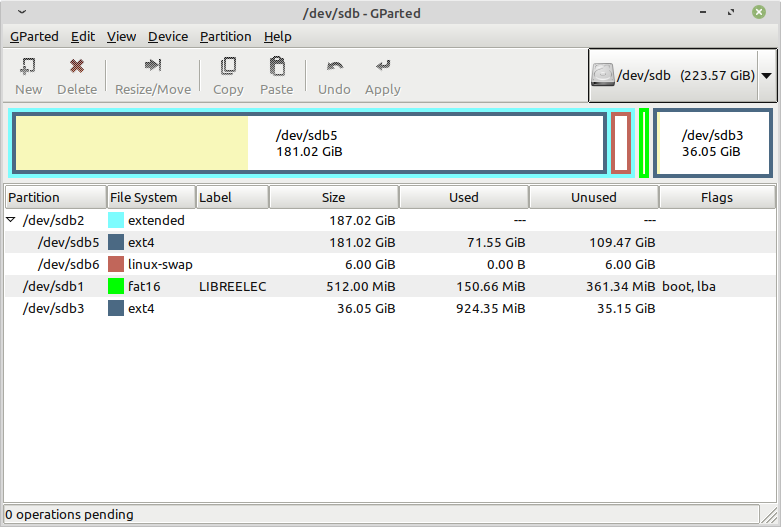

    Easy to do from any Linux OS with gparted:
    in short you copy/paste both partition from sdcard to SDD and set boot flags as in sdcard and you are done. Probably first you need to resize/downsize existing partition from SDD if you don't have free unallocated space
    You can see here how I just added an working LE (sdb1 and sdb3) from a 2Gb sdcard to an SSD just to test new option USB boot on RPI4.
    This SSD did not had any free space left but I downsized sdb5 and sdb2 and moved sdb6 existing partition and I also expanded data partition from sd card LE install sdb3.
