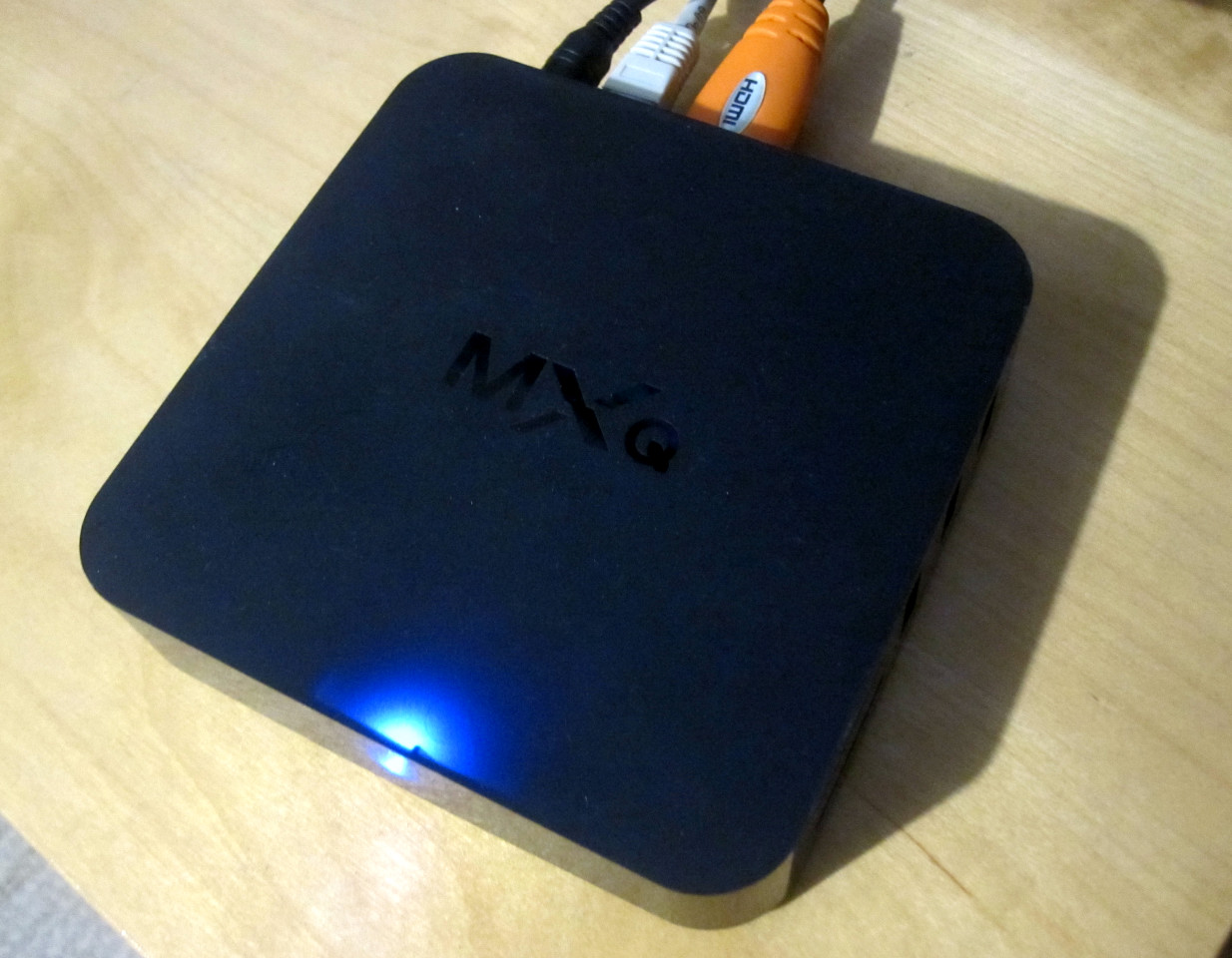

  • I just spend the evening trying to get this build installed to nand on my MXQ s805. All of my attemps failed.
    First, i wrote the image to sd. Booting from sd with toothpick method works fine. After enabling ssh, i ran the installtointernal command. The first attempt resulted in no errors. But after a reboot i only get "Android system recovery <3e>" showing "no command" error.
    After this, i tried the recovery install procedure with 7.0.3.3.a build. I installs fine, but after rebooting it freezes showing the libreelec logo.
    After this, i tried again install with "installtointernal", now with 7.95.beta.5a . Again i can boot from sd. But now this is wat happens:
    Backing up remote.conf...mount: mounting /dev/system on /tmp/system failed: Invalid argument
    umount: can't unmount /tmp/system: Invalid argument
    done.
    Writing kernel image...88+1 records in
    88+1 records out
    5781504 bytes (5.5MB) copied, 3.520047 seconds, 1.6MB/s
    done.
    Formatting SYSTEM partition...done.
    Copying SYSTEM files...mount: mounting /dev/system on /tmp/system failed: Invalid argument
    done.
    Formatting DATA partition...done.
    Do you want to copy your user data to internal data partition? [Y/n] n
    All done! You can now continue using your LE system or type "rebootfromnand" to reboot from internal memory.
    Again tried 7.95.beta6, same result.
    To sum things up: i can do recovery with 7.0.3.3 but this won't boot LE. With 7.95.beta6 i can boot from sd but cant install nor boot from internal nand.
    Please help...

  • I haven't tried HD18Q builds. Will go and test it tonight. Keep you posted.. Thanks for the advice.
    Just installed the HD18 build. Installs perfectly. For whom is facing the same problem, this concerns the black "mxq" box with black logo. I'll attach a photo of the box. Even the remote works again with the HD18 remote file. The installtointernal copied it immediately.
