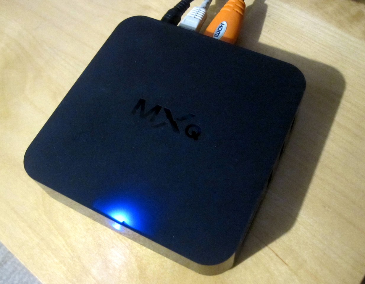

Just installed the HD18 build. Installs perfectly. For whom is facing the same problem, this concerns the black "mxq" box with black logo. I'll attach a photo of the box. Even the remote works again with the HD18 remote file. The installtointernal copied it immediately.
