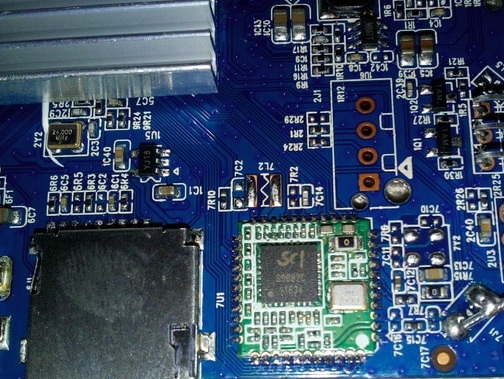

just wondering if some one can help me with proper device tree for this box,, everything works ok ,,except dont have no wifi,,
maybe someone has extracted dtb ,,
thanx
this is the wifi module since it is closest to the antenna wire. it reads SCI s9082c,,,
Site Search Results | Wi-Fi Alliance | Wi-Fi Alliance
if someone has solution for this chip or driver,, -
No driver available. See thread-5457.html.
You can use a supported usb WiFi stick.
