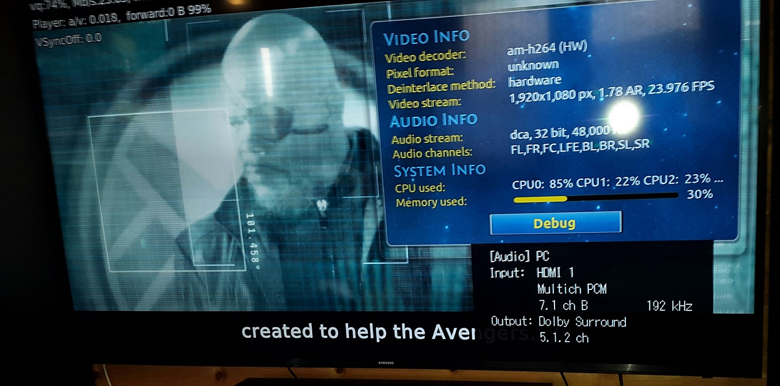

When the device is decompressing the audio, it is limited to 96khz (as kszaq suggests) due to restrictions in the onboard DAC. When you passthrough the DTS-MA track, the device does not touch the original bitstream and your amplifier decodes the audio at the full 192khz.
