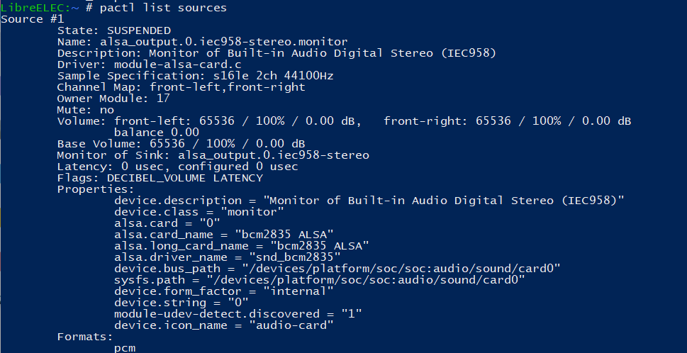

  • Hello everyone.
    Same as OP, I have RPi 3B+ with LibreELEC, and I want to use it as bluetooth audio sink.
    I have another problem - I can't add bluetooth as source.
    When I type
    pactl list short sources
    no BT source available, and only result is
    Quote
    1 alsa_output.0.iec958-stereo.monitor module-alsa-card.c s16le 2ch 44100Hz SUSPENDED
    Listing modules with
    pactl list short modules | grep blue
    shows that exist
    Quote
    10 module-bluetooth-policy
    11 module-bluetooth-discover
    12 module-bluez5-discover
    but loading any of them results to error message
    Quote
    Failure: Module initialization failed
    So, I'm kind of stuck now. Can you advise something?
    Thank you.
