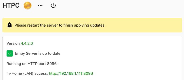

Hello,
I submitted these pull requests to update Emby4 to the current latest release (4.4.2.0):
emby4: update to 4.4.2.0 by awiouy · Pull Request #4335 · LibreELEC/LibreELEC.tv · GitHub
Thanks awiouy! ![]()
